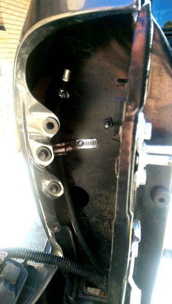

    Got mine done and ended up placing it behind the taillight. Easy peesy and no holes to drill.

    Pull your tail light off and mount it behind there, way easier and a 15 minute job.
