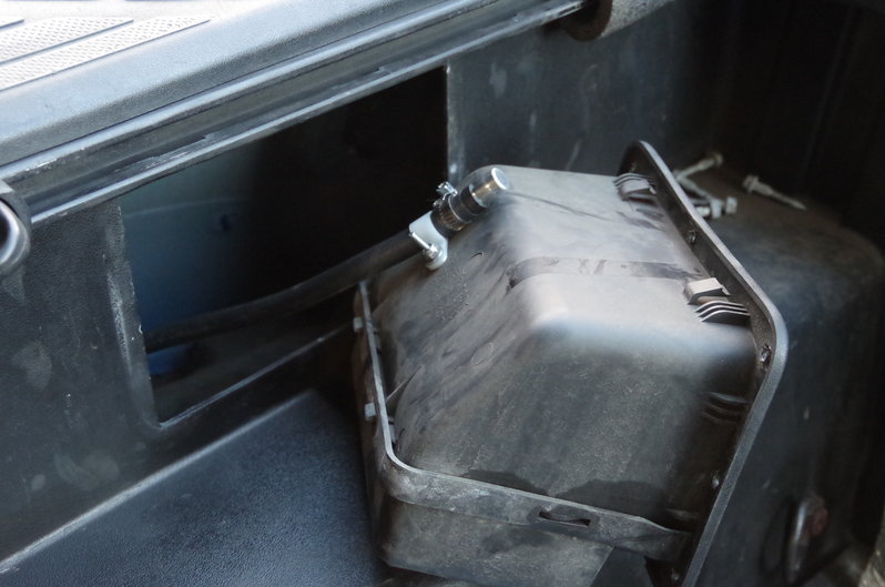

  16. Dec 5, 2015 at 2:17 PM
    #656
    Subway4X4
    Subway4X4 Shameless Copy Cat
    Nov 10, 2015
    #169260
    11,668
    Lloyd
    NY/NJ
    05 Speedway Blue DCSB OR TRD
    Everything TW members recommend
    That was easy...
    Mounted the upper breather assembly to the back of the left 'open" cubby.
    Now I can safely (for my differential) cross deep water flooded roads over 18 inches to get to work :)
