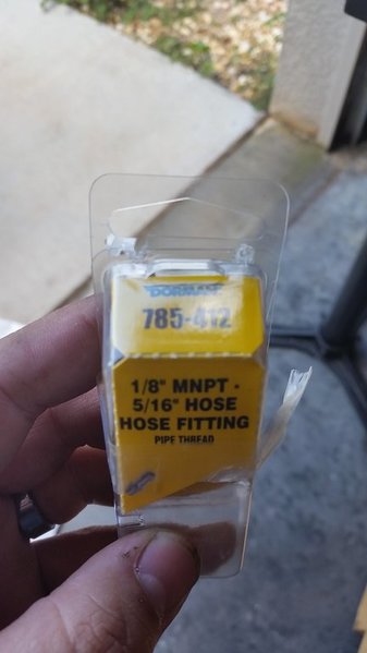

    OP used 1/4" I.D. fuel line, which fits nicely over the the hose barb that he posted. Others have used 5/16" I.D. fuel line which would likely fit better over the larger diameter hose barb (the silver one I believe)

    I know members have used both and none have reported any problems yet. But for my personal preference, part#5139 is closer to the same diameter as the breather union so it would make sense to keep it together for the same hose. I actually bought both of them and didn't realize unitl I got them that they were different. On a related note, I have part #90404-51026 up for grabs if anyone wants it. $5 shipped. Haha!

    I bought 5' of 5/16 fuel line and the hose fitting. Used the factory breather and just clamped it into the hose.
    Tookaybe 10 minutes to do this

    What size line is everyone running? OP used 1/4, but ive also seen 3/8 and 5/16
