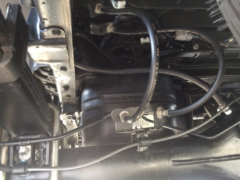

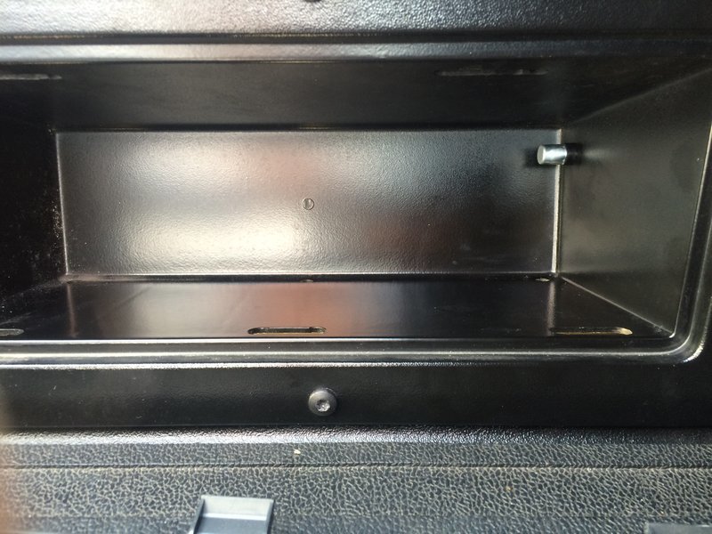

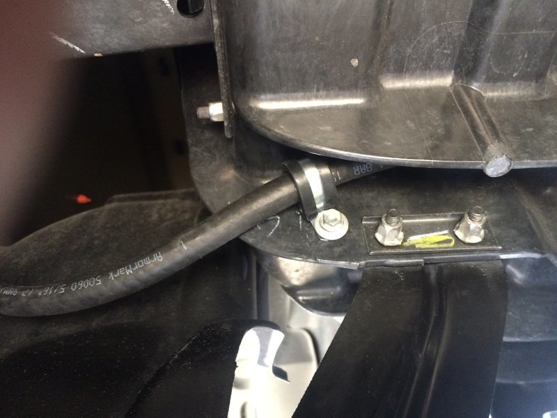

    I would think there the same. Just my opinion. When I did mine I used the bigger diameter Union. Part # 90404- 51319 with 5/16 fuel line.image.jpgimage.jpgimage.jpg

    Sounds good. I like where you relocated the breather. I think I'll do the same. Thanks.

    Thanks. I took the cubby out and drilled a 3/8 inch hole. This aloud the breather to partially fit thru the hole and stop, then slid the hose on with a clamp from the back side. It can't go nowhere. I also used dielectric grease for A lubricant to slide the hose on both fittings. It was tight.
