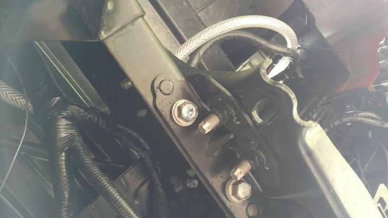

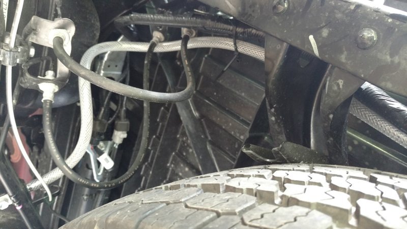

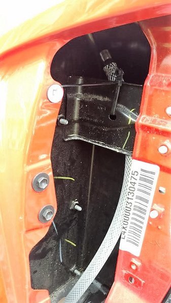

  18. May 30, 2016 at 8:26 AM
    #718
    RNJNKE
    RNJNKE Pounding Trails
    Dec 29, 2015
    #173433
    480
    Russ
    VA
    2016 Tacoma TRD DCSB OR, Inferno
    '17 TRD PRO SEMA Wheels, 265/70/17 BFG AT KO2, Prinsu Racks, A.R.E Overland Topper, Redline Tuning Hood Strut, Relentless Fab Locking Bed Doors, Waterport, Angry Beaver
    FINALLY got around do doing this mod. It was one of the first mods I shopped for before I got my truck and by far one of the easiest to date.
    I don't know why I waited 4 months.
    Glad I browsed all the posts here for ideas. As I tagged along and placed behind the tail light. EASY PEASY!!
    Ran from the Diff up over the spare tire, following the break light bundle.
    Over the tire, and up the Driver side tail light.
    Breathing nice and high!
