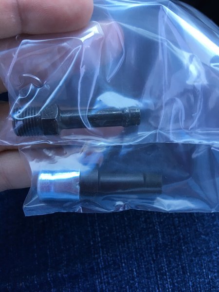

    Just picked up the parts from the dealership. The breather looks right the union looks small in caparison. I guess I'll find out on Saturday.

    I got these parts recently too and noticed the same. There's another thread with a different part number for the union that looks to be bigger (kinda wish I'd seen that one sooner). I'm gonna roll with what I have (same union from this thread) and just use some hose that fits it (and fight to get it on the breather, use some soap, etc.). I figure a tight fit at the diff is whats most important and we can't be talking about that much air moving through this hose when you dip an axle in cold water (so 1/4'' hose vs 3/8'' hose, from the other thread, should make a huge difference).

    Check out my post, this should help! https://www.tacomaworld.com/threads...-3rd-gen-today.399305/page-1053#post-12516753
    I used the larger union from Toyota which works really well
