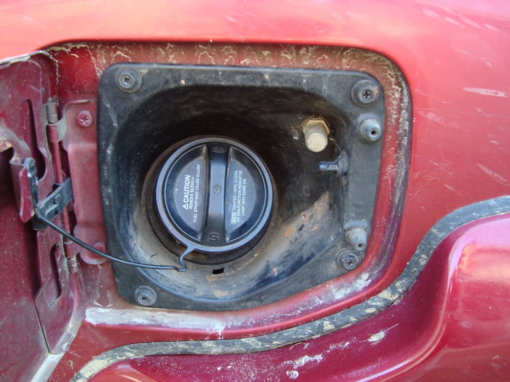

    Thanks. I'd always seen it black. I'll check out Lowes. :)

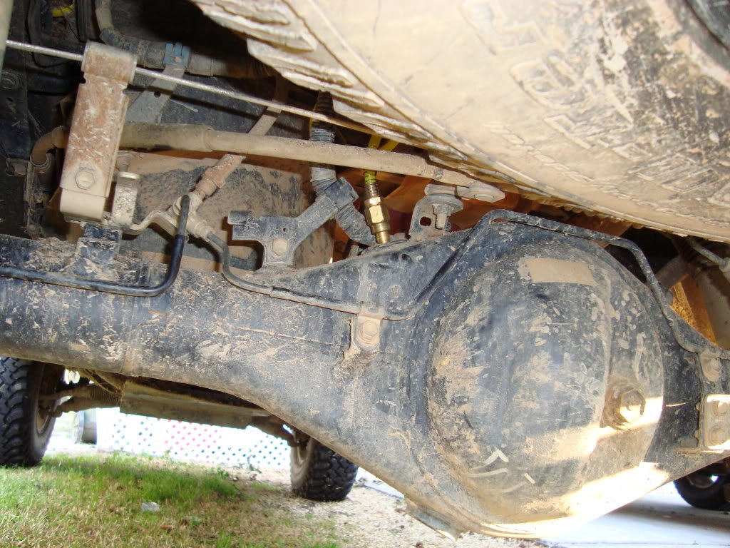

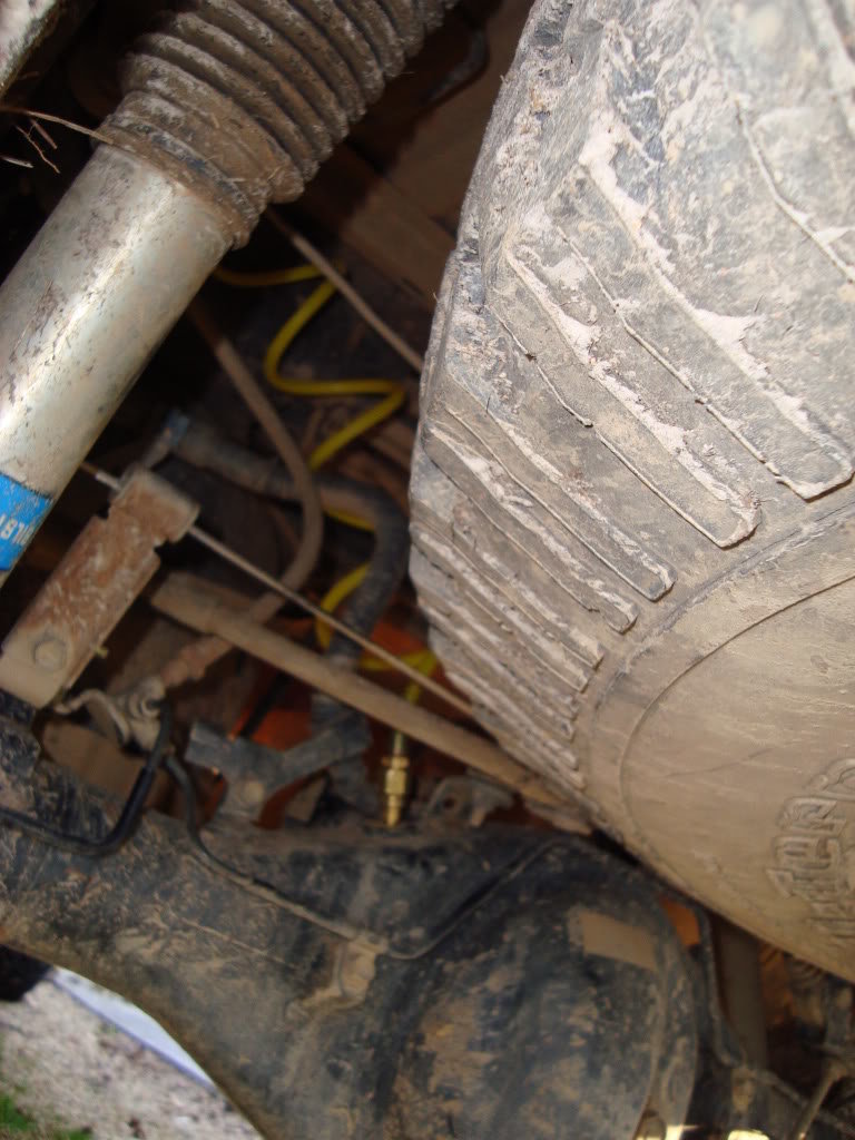

    There is slack...bad picture. You like it mounted in the well?

    the yellow line is kinda of pimp...i like it.
    Question:
    The breather I took of had some play in the cap itself. The new breather did not have any play.
    Any takers?
    -Al

    Not a problem. Mine was the same way. To be sure, I "blew" through the new breather plug like blowing through a straw, and the air passed through just fine. I did the same thing with the diff end of the hosing right before connecting it to the diff, and again, the air went through no problems.
    I think the replacement part is supposed to be "always open" in a sheltered area while the original breather on the diff itself is supposed to open/close depending on conditions, hence the difference.
