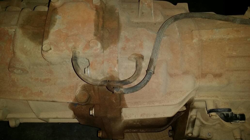

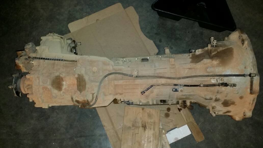

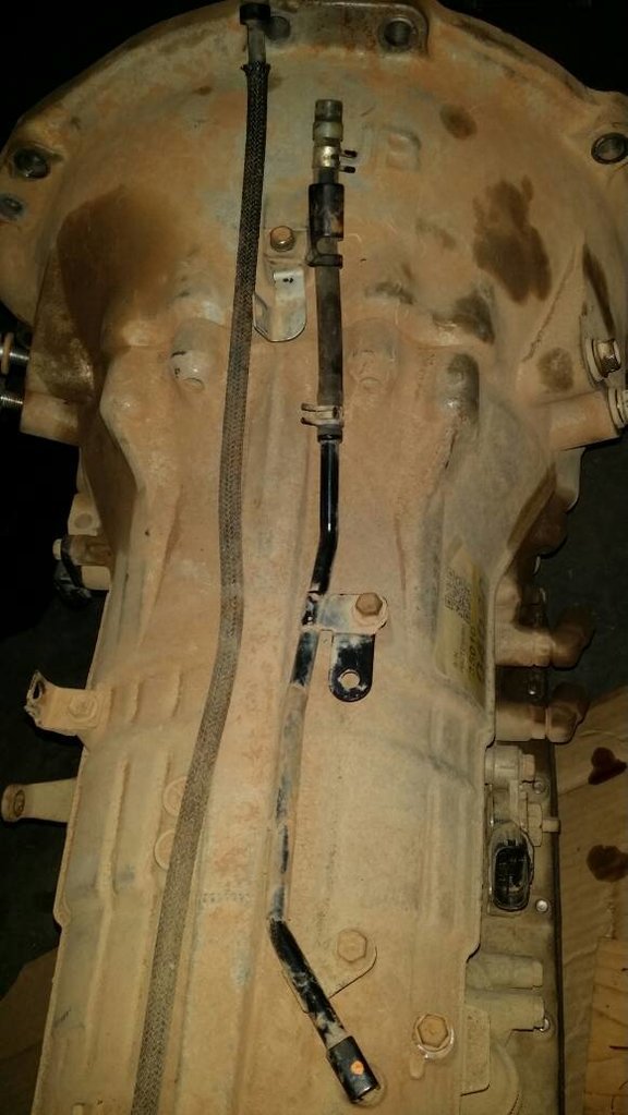

    @06Offroad Thanks for posting this (and the subsequent seal information). Great information that has alluded all of my search attempts up until now. Did you ever end up extending these breathers, and any pics?
    Anyone else extend the Transmission and Transfer Case breathers while the transmission was still installed? Cannot find a how-to that's applicable to 2nd Gens for the life of me. Everything is either 1st Gens, FJs (which seem to be a different story), etc...
    Also, can any one (@David K ?) confirm what the deal is with the e-locker (separate from the rear diff) breather? Saw a post somewhere that showed it's a bare 1/8" nipple just sticking out of the axle or crossmember or something weird like that (wha??). But I've also seen a few posts that show a ~1/8" hose coming out of the e-locker and bundled with the wiring harness that goes somewhere. I think one post mentioned that hose routes up and vents up near the fuel cap, but would love some pics of the far end of the hose or at least a confirmation on whether it needs to be raised/extended further. My goal is to make sure no breather is any lower than the front diff / ADD breathers up by the battery.
