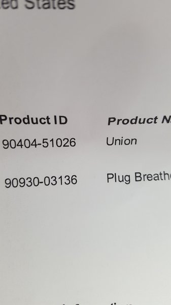

    Are these the correct part numbers? How can you tell is the diff breather is two way or not?
    Wakecoach likes this.

    dont know if it is mentioned anywhere in this thread but the fittings used by Toyota are BritishStandard Pipe Thread..the rear diff is a 28TPI ...1 TPI more then those in use in the USA or National Pipe Thread fittings.....there also is a difference in taper and angle of threads etc....

    Picked mine up yesterday from Toyota. $10 for the two parts. Definitely a breather @Jamma
    Jamma likes this.
