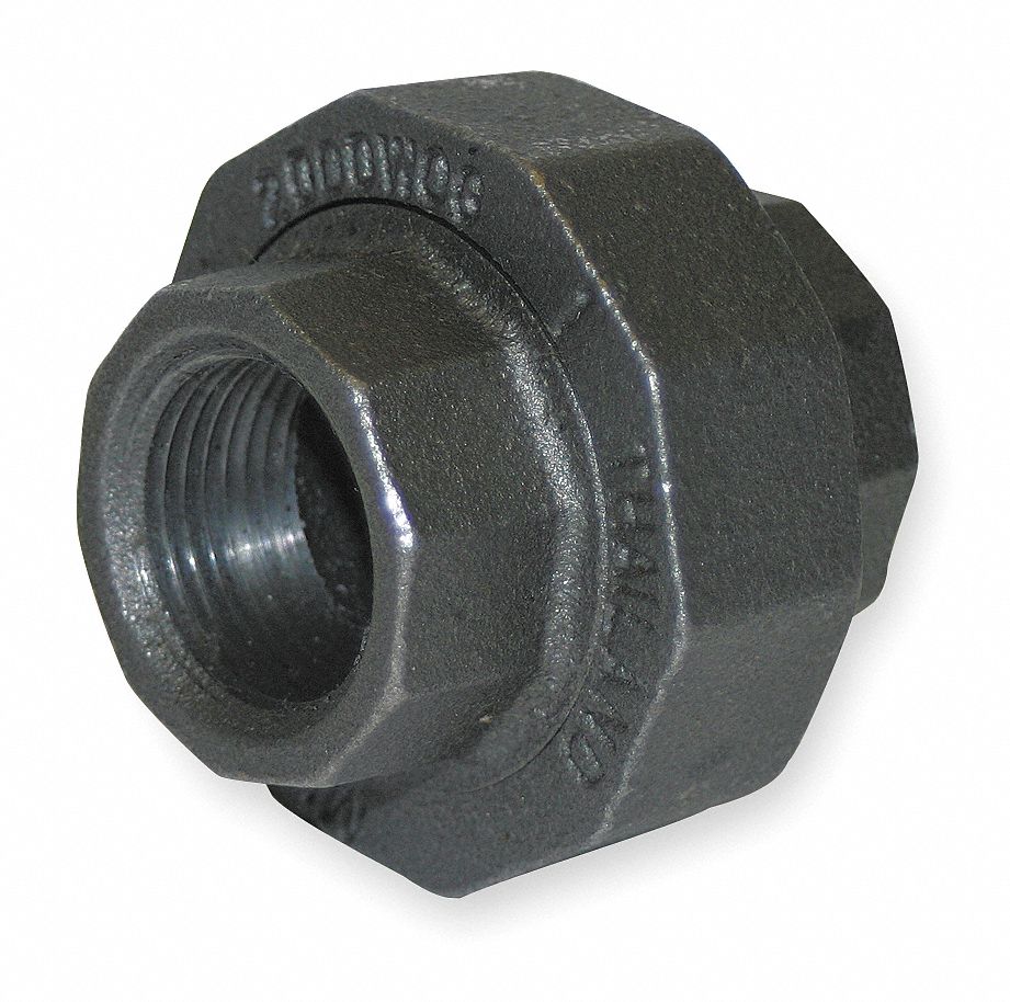

    wmg
    wmg Well-Known Member
    Jan 20, 2017
    #208119
    1,012
    bill
    2009 FJ
    BP-51 OEM LIFT..33;s...full skids....dual Batteries
    [​IMG]also not to be a ball breaker but this is a pipe union..the fitting incorrectly named is a threaded/hose bib...these are used in long runs of pipe systems to insert a device which may need to be removed for repair/replacement...like a steam trap or filter housing.....

    wmg
    Jan 20, 2017
    #208119
    1,012
    bill
    2009 FJ
    it is a british standard pipe thread...not metric.... 28 threads per inch

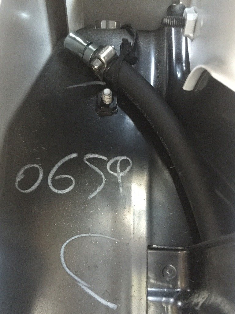

  4. Jun 8, 2017 at 3:57 PM
    #824
    wmg
    Jan 20, 2017
    #208119
    1,012
    bill
    2009 FJ
  5. Jun 9, 2017 at 1:19 PM
    #825
    wmg
    Jan 20, 2017
    #208119
    1,012
    bill
    2009 FJ
    did the front today..more to replace the goofy Toyota breathers with a true open breatherDSCN1317.jpg

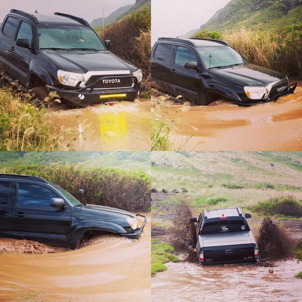

  6. Jun 9, 2017 at 1:25 PM
    #826
    seoulja99
    seoulja99 Well-Known Member
    Mar 8, 2016
    #180618
    2,559
    E.J.
    Oahu
    2012 DCSB 4x4 V6 TX Baja (1GR-FE)
    all things mall rated
    Mine would get flooded and/or caked in mud if I had it place there. :mudding:

  7. Jun 9, 2017 at 3:06 PM
    #827
    Glenn_R
    Glenn_R The Unicorn Turd Gen
    Nov 8, 2016
    #201874
    1,142
    Glenn
    17 Tacoma DCSB OR Inferno
    You submerged the engine?
  8. Jun 9, 2017 at 3:08 PM
    #828
    Rackness
    Rackness Well-Known Member
    Apr 30, 2017
    #217715
    977
    Jason
    Maryland
    17' Tacoma
    Working on it.
    The mod was super easy with all the forum write ups and instructions! Knee high water beware!:burnrubber:

  10. Jun 9, 2017 at 7:34 PM
    #830
    Glenn_R
    Nov 8, 2016
    #201874
    1,142
    Glenn
    OK, you didn't submerge the motor. I was wondering how you could swamp that breather location without a snorkel.
  11. Jun 9, 2017 at 8:01 PM
    #831
    seoulja99
    Mar 8, 2016
    #180618
    2,559
    E.J.
    Oahu
    And I installed a snorkel after that. While installing the snorkel, I had to clean out the hose that leads to the airfilter because there was dried up mud inside. Luckily the air filter was clean and the mud didn't reach it at all.
    VA SOFTACO likes this.
