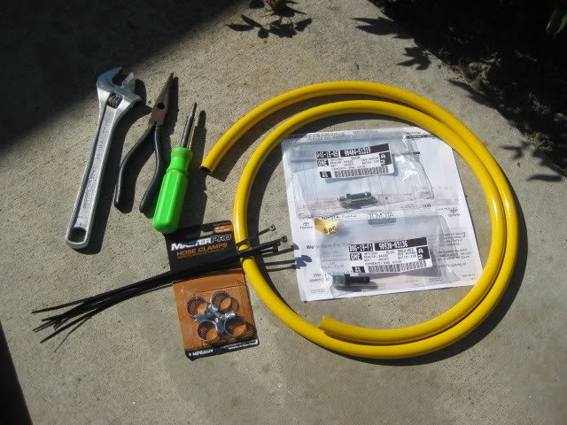

    I don't know where you all are getting these parts so cheap. All in it's about $30 from Amazon. I decided to go ahead and do this mod since I'm watching the hurricanes and for some reason I've started getting sort of stressed about them, even though I live in NOVA and no where in the path of them. Had to gas up my cars and get the generator tuned up and this mod. No idea why. :notsure:

    I got the 2 parts from an online dealer in Michigan for $12.xx shipped. Then 6ft of hose from Advance for like $6.

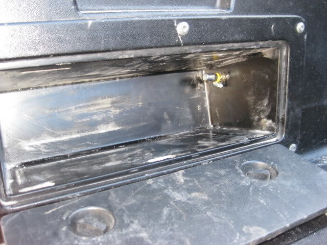

    i just did mine today. routed breather to cubby in rear bed of truck

    Called dealership and the two breathers are about $18 together.

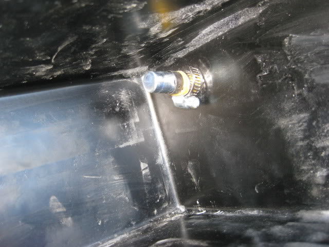

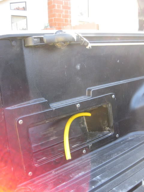

    Just got the breather mod done with my son's help. pretty easy mod. mounted it up through the tail light and zipped it to the hole there.
    thanks for the info guys!

    Hmmm, cheapest I can find is $12 for the union and $7 for the breather .... is that about right for the going rate?
