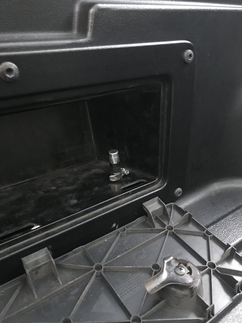

    Did it last week, into the little storage compartment. I also found it all as a kit for $25, much easier than the dealer even if it was a few dollars more.

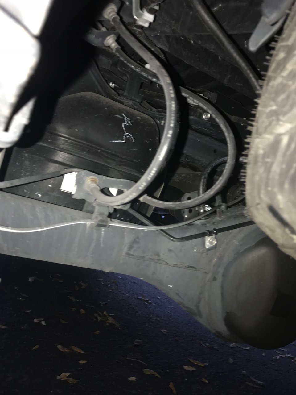

    I am not going to lay down under the truck tonight, but these pics should give you an idea. I routed it along the inside of the frame, it’s really the only place it can go. It’s zip tied loosely to another line. For the box, I removed it to drill the hole. That website shipped very fast too.
