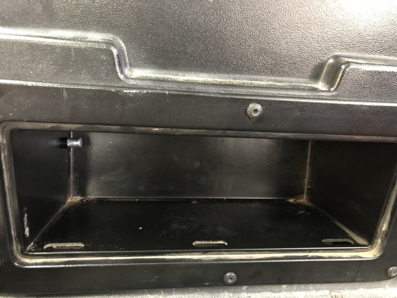

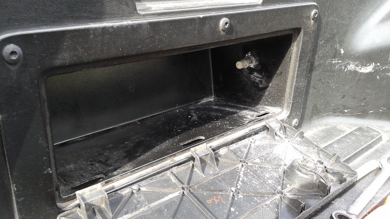

    anyone have tips on how to get the breather in the line it just won’t go in

    Use some spit, or some type of lubricant.
    You're talking about putting into the "hose", right?

    Put mine in the cubbie

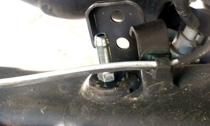

    One thing I did different - after looking at the installation of the fitting in the axle - bought an elbow fitting to go in the axle instead. The straight up fitting and attached hose looked too much like a target for brush or rocks. The 90 degree outlet allowed running the hose across wth the brake tubing on the axle.

    Unable to get a good camera angle to view this today spare is in there - but this is how the hose fitting sticks up out of the axle housing......
    The 90º elbow fitting is 1/8 BSP and looks like this.... got 304 stainless one off ebay from (of course) CHINA...
