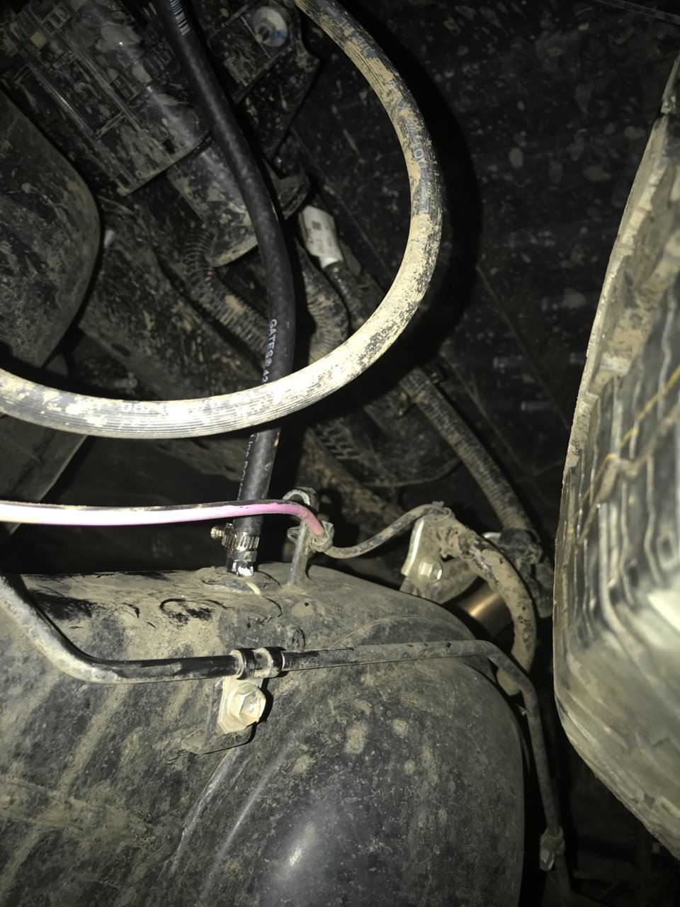

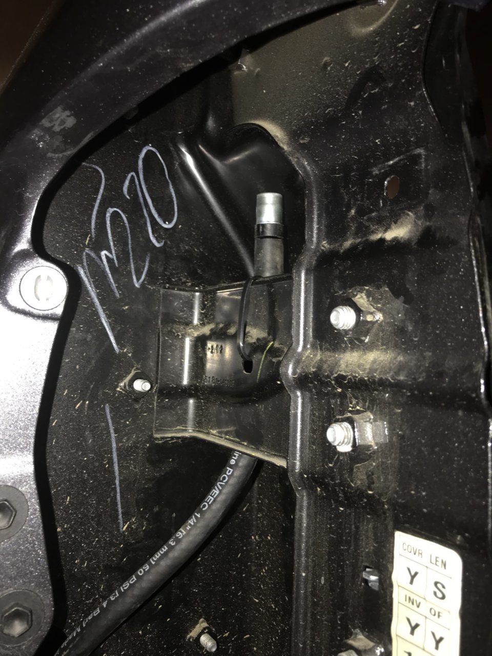

    Nice rainy Saturday morning mod. I went behind the driver side taillight. 8C7F6A55-7216-4346-8F48-C691A4B8F253.jpg 335776B6-A6B7-4213-9835-4DAC24B4D9F3.jpg

    Nice! I went in the gas tank door. But I wish I would have done the tail light like that. The gas tank door isn’t in the way, I just like the hidden idea better.

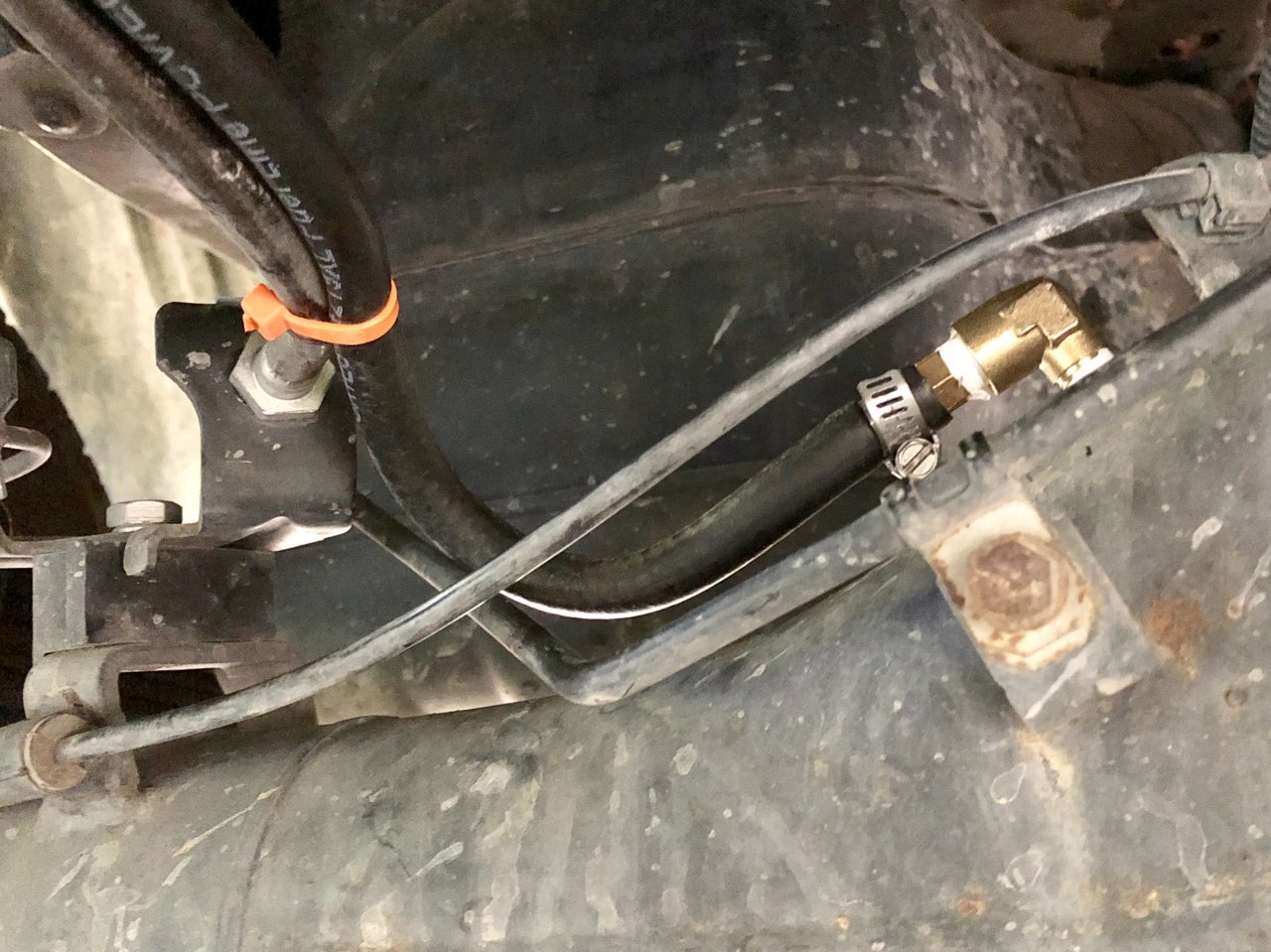

    Just installed mine. I added a right angle fitting mentioned a couple pages back to keep low profile then ran the hose to the brake lines and zip tied it up and along one of the brake lines. Right angle fitting $2.99 and another $2.99 for brass barbed fitting from local hardware store.

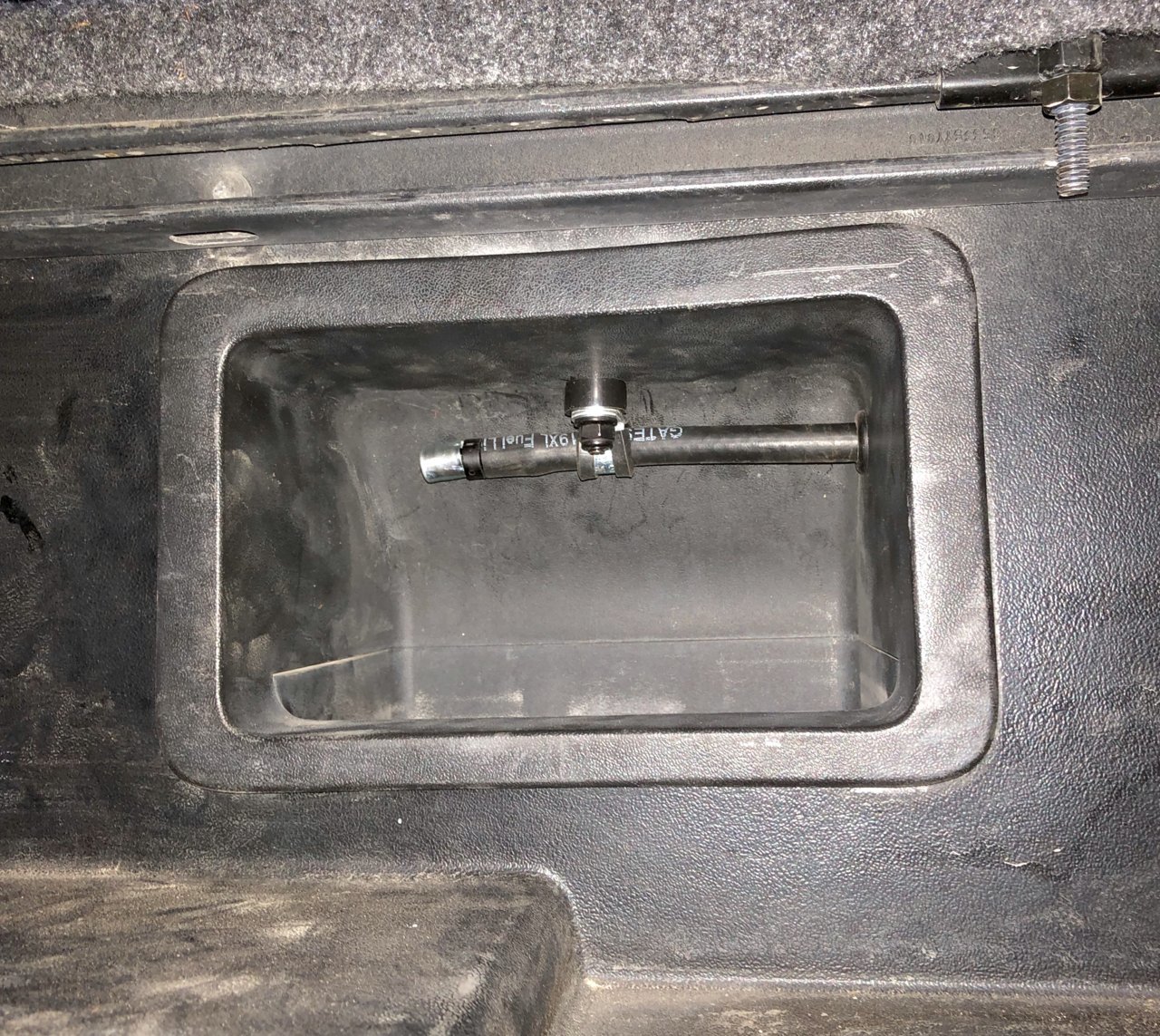

    Then to be different, I mounted breather into one of the side pockets. I figured with my camper shell the inside of the bed would be driest place for a breather. I tried mounting the breather direct to side of the pocket but the barbed end stuck too far out and I couldn’t get the pocket to fit back into the bed so moved it to the middle.
