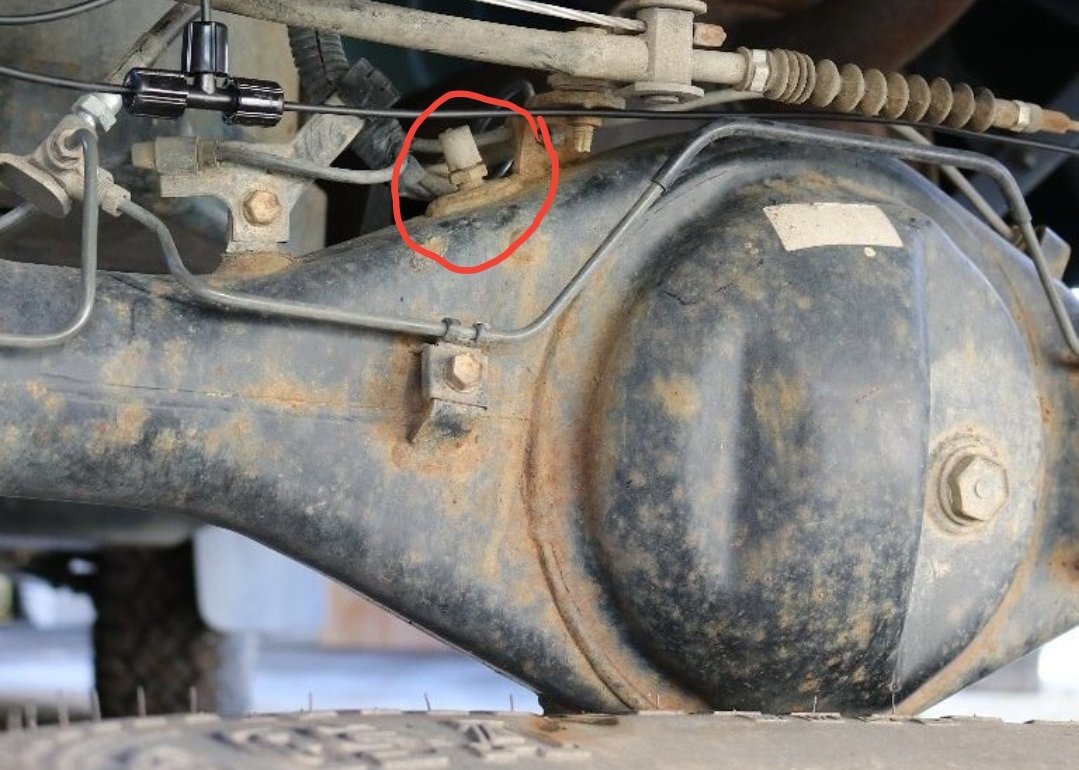

    Stock. Looking for suggestions of best mods.
    Hey there, Thanks for your write up!
    Just got the tubes, filter and other items to move my diff breather up, crawled under the truck and can’t find anything on the differential! Totally confused and feeling doopid. The diff lock motor has one, but not the differential itself. Where’s it located? I have a 2006 TRD off-road.

    crashngiggles
    crashngiggles Tacomaworld's Resident Psych Dr.
    May 17, 2015
    #155446
    7,462
    Jared
    Wilbraham, Massachusetts
    2013 MGM TRD 4x4 DCLB Trail Limo
    stbear and ACEkraut like this.

    Worldflier
    Worldflier Well-Known Member
    Jul 5, 2019
    #298370
    45
    Dre
    Bay Area, CA
    2006 Dark Blue (indigo ink pearl) TRD Off-road
    Thank you! I’ll crawl underneath again tmrw for another look.
