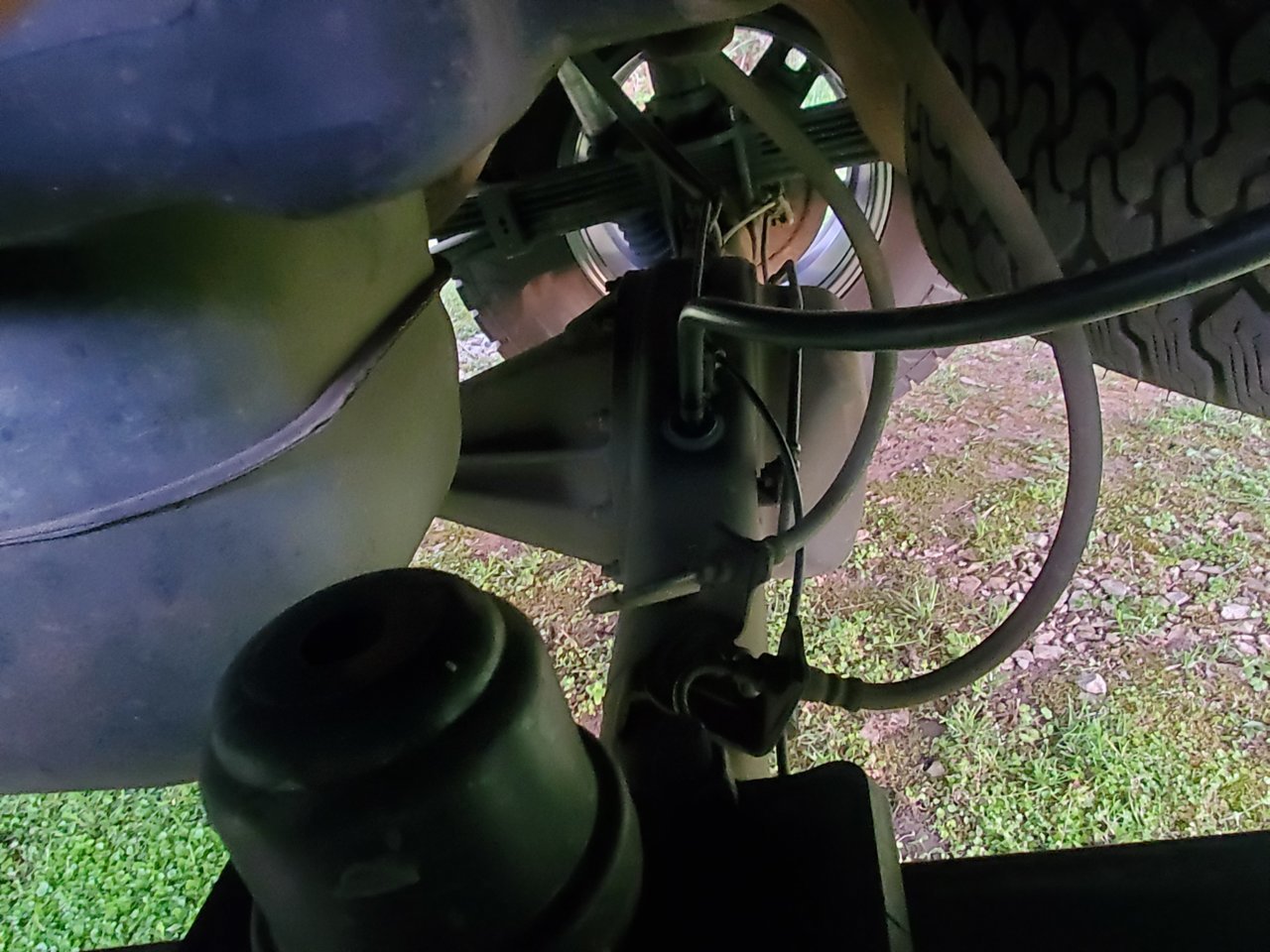

    With all the flooding going on in the south figured this mod would be a good Idea.
    Used 7ft of hose to put the new breather in the gas tank pump area and didn't find it necessary to use any zip ties.

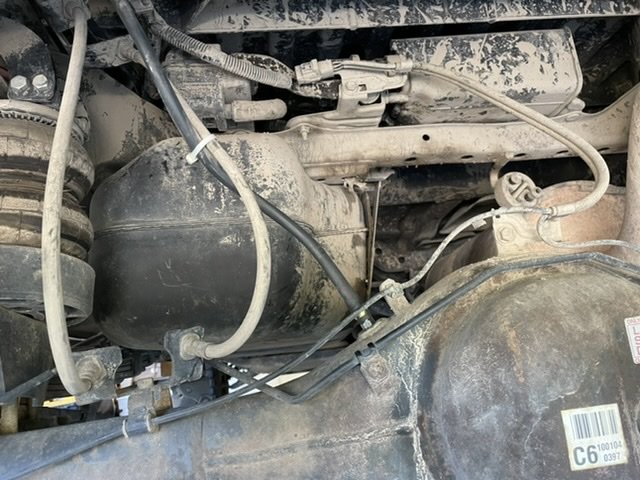

    Been on the TODO list for too long. Finally knocked out it out this morning before another camping trip next weekend…

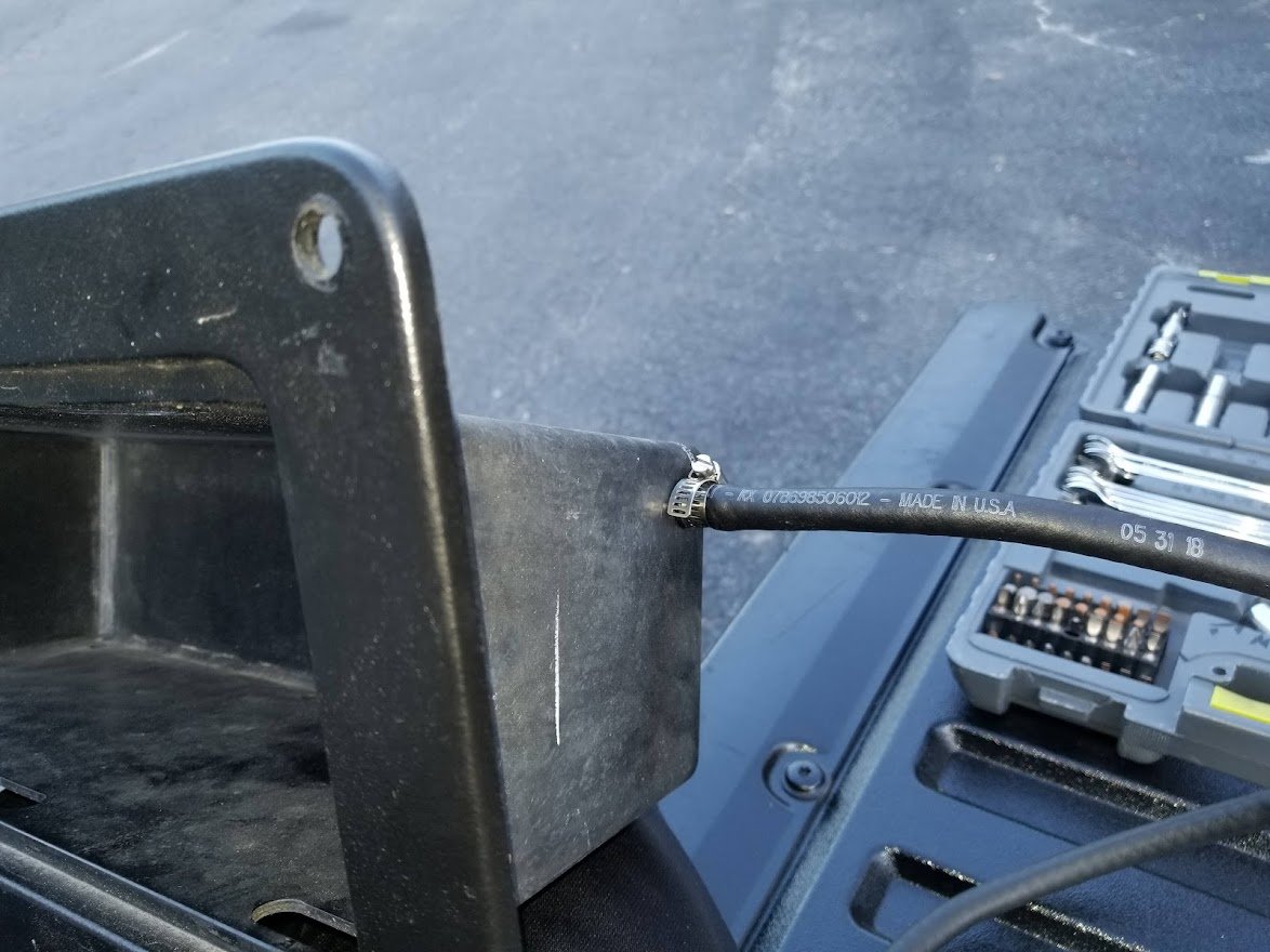

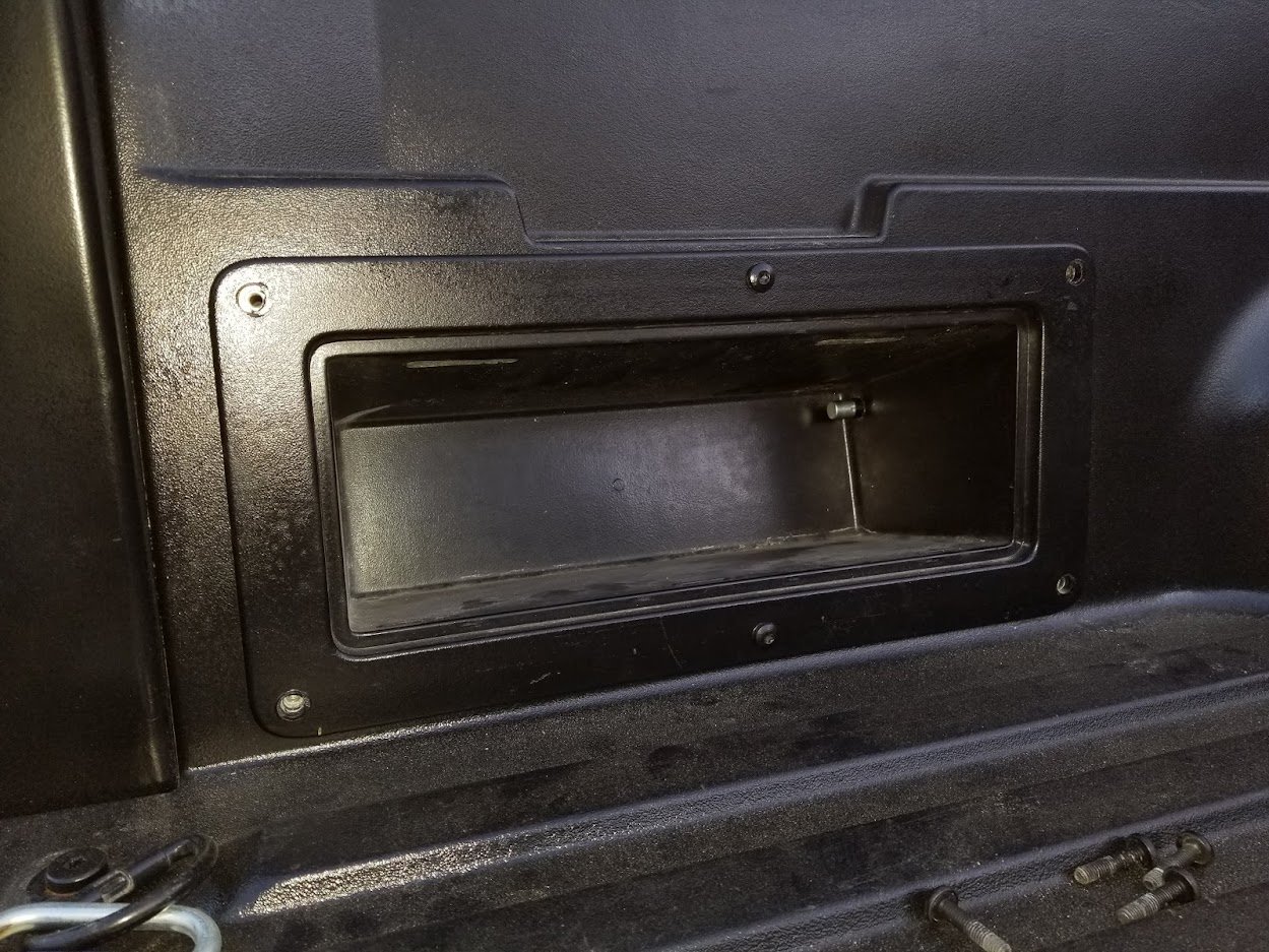

    This was one of my first mods! Did the driver's side bed cubby.

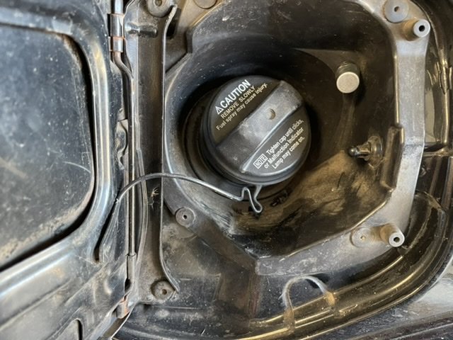

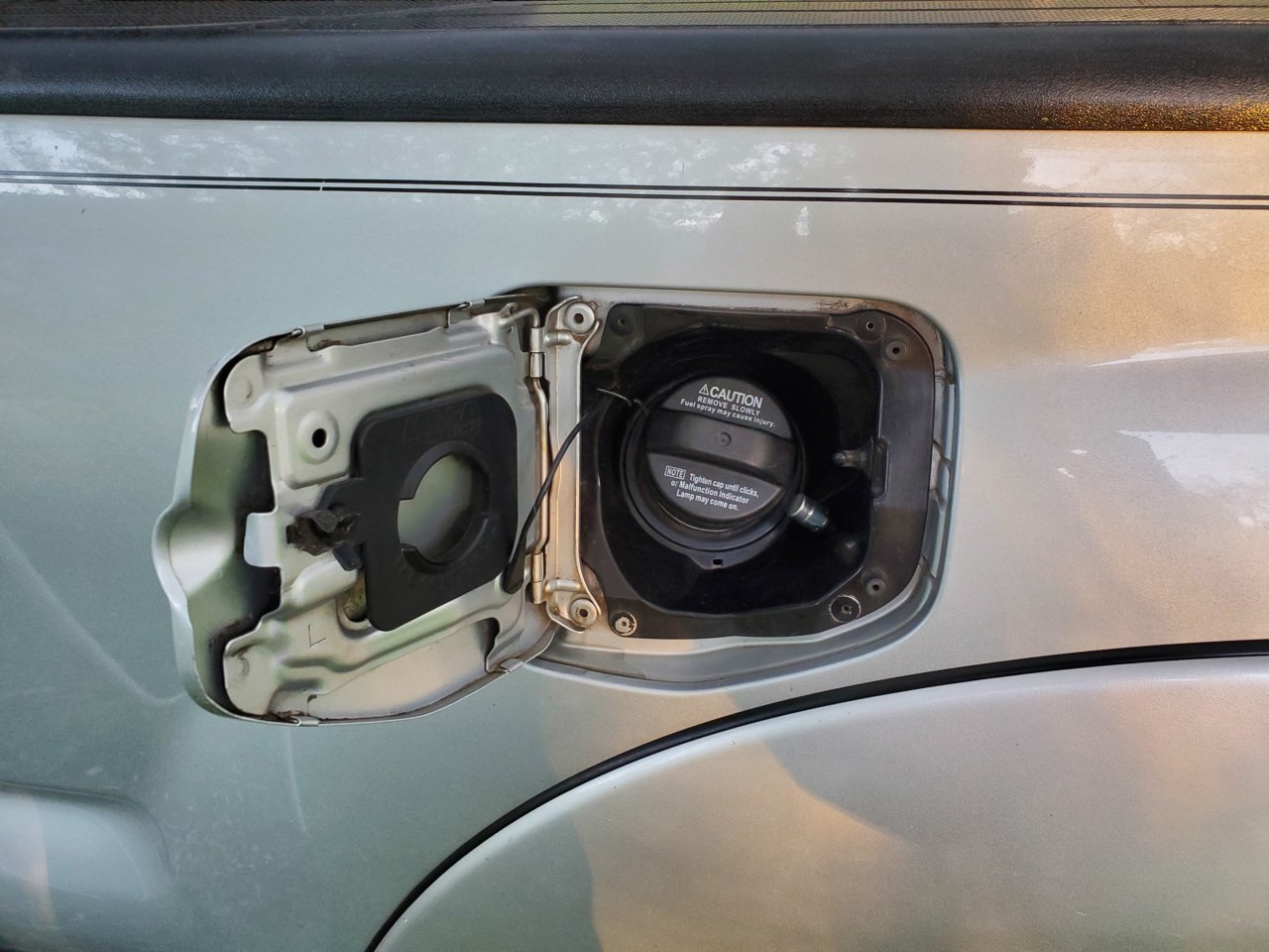

    Went ahead and did this today, went for a fuel door location like the OP. Used 6' of tubing and had plenty of room. Two zipties finished it up. Was a bit of a pain trying to get the hose onto the breather (tight fit) with a topper on and ended up with one hand in the fuel door and one under the wheel well.

    cant you just remove the fuel filler cover to gain access to the back of the filler surround to do this?

    Haha apparently that was beyond my thinking capacity.
