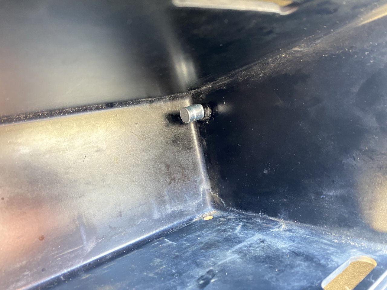

    The new breather piece was a PITA to get in the tube, but it’s done!

    What year do you have? My 14 doesn’t have those extra pockets. Just completed this in about 10 mins though, placed it behind the passenger tail light, thanks for the write up!
