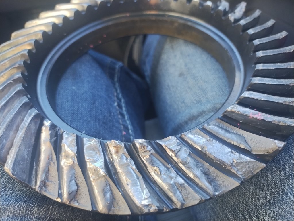

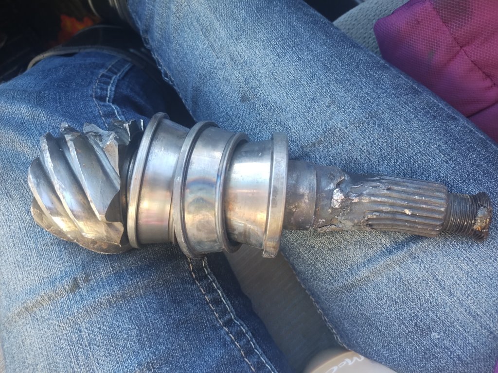

    Okay. So $1300 for the rebuild and $400 for the front CVR axel replacements. Said drive 45 minutes wait 20, check the gear oil level. So the same thing again...... Done driving about 200 miles and stopping for the night..... Question is, is he rebuilt the ring pin and put new spacers in, and then the CVR axels we're replaced, all new shit all up front....... Am I good? I'll pay pictures of the broken parts.....
    I guess what I'm asking is, if they rebuilt it the exact same way at a great ratio of 4.88, so I have 4 wheel again, and what about my lockers??

  15. Nov 26, 2024 at 10:25 AM
    Sh!tshow4x4
    Sh!tshow4x4 [OP] New Member
    Nov 14, 2024
    #460625
    Dani
    2000 Toyota 4runner, V6.
    ARB lockers and compressor, Front and rear
    Here's the damage done☹️
