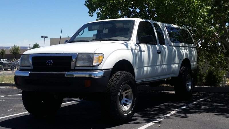

    My truck currently:20170611_114349.jpg

    Looks just like my truck!
