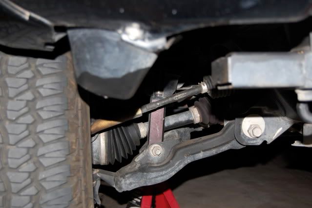

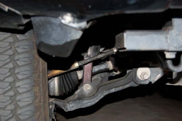

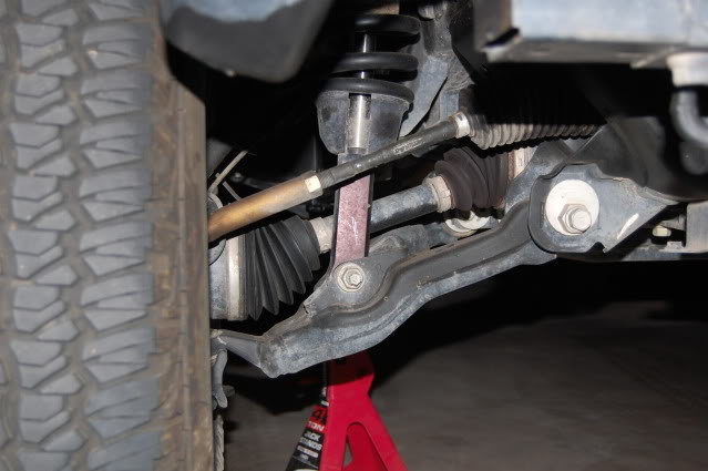

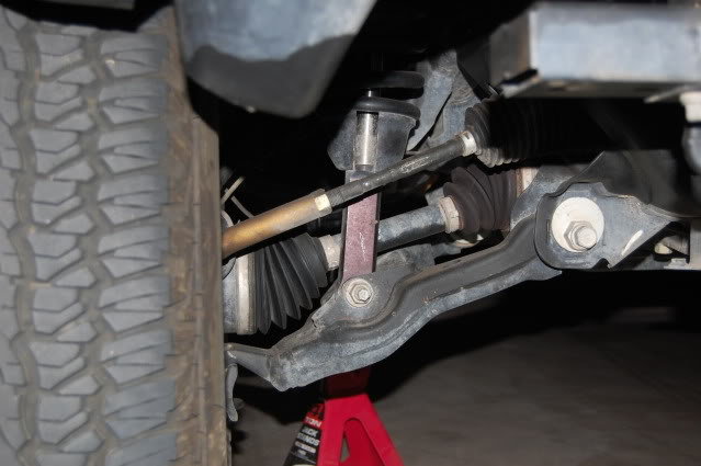

    okay, so i'm tired of my skid plates not fitting right with this differential drop in so did a little test to see how much they actually help, and this is what I came up with
    I have icon c/o at 2.75'' with total chaos uca's
    I put the camera on a tripod to hold it still and took pictures on the same spot so it would be easy to compare.
    This is a picture with the diff drop in and the truck on jack stands w/ wheels in the air
    This with no diff drop and the truck still on stands
    Here is what they cv angles look like with a diff drop in and the truck sitting on the ground
    and what the angles are on the ground w/ no drop
    I didn't take the same picture 4 times and call it a night, i was actually very surprised to see how little it effected it. I'm not sure what the effect on vibes will be. I had no vibes before so we'll see if they show up with no diff drop in
    I'm not claiming that a differential drop doesn't do anything or whatnot. I'm just showing a comparison w/ it and w/o it
    I just thought it was very interesting and thought i should share it and let people make up their mind weather they think it's worth it or not

    Kinda why I tell people not to bother with it unless needed. It only changes the angle less than 2*

    When you compare the last two pictures, there's a bump or spot on the right hand side of the lower portion of the shock about half way down...you can see a difference in angle there between that spot and the cv axle.
