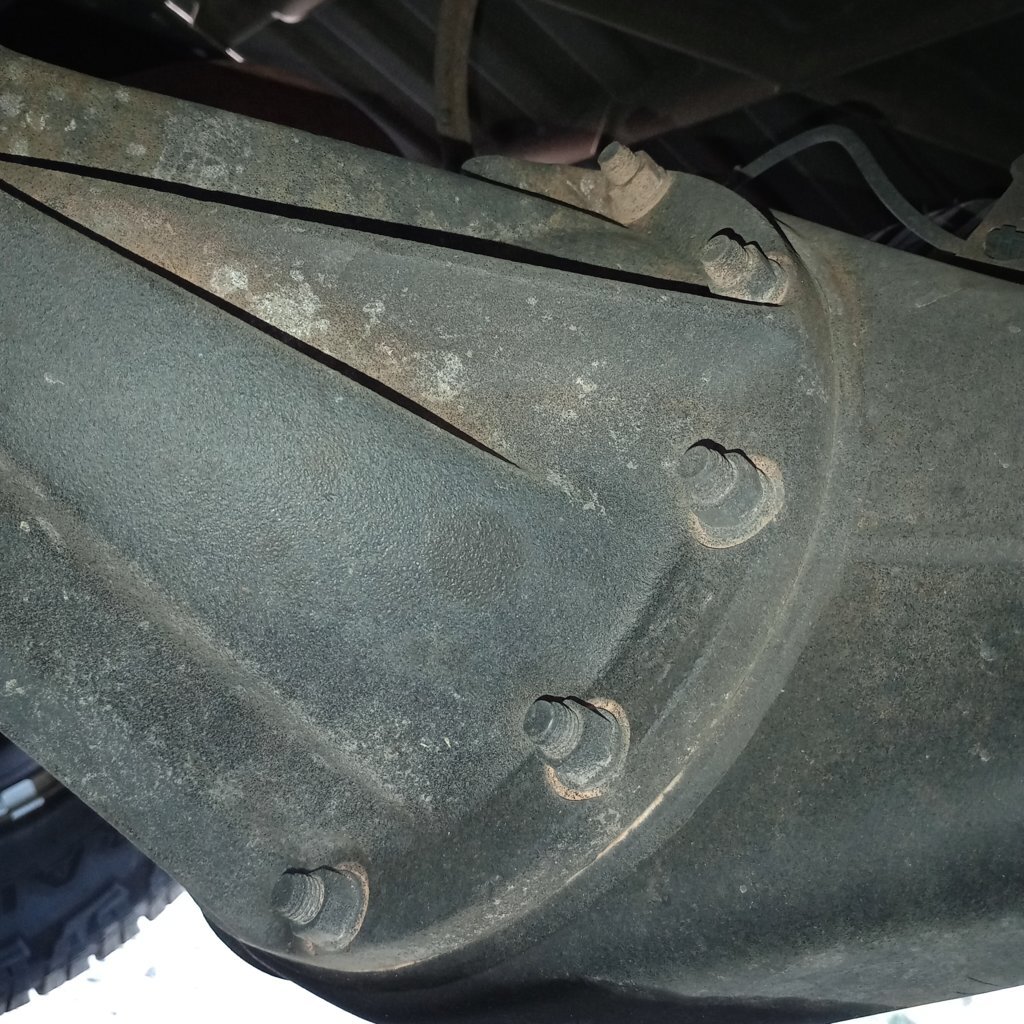

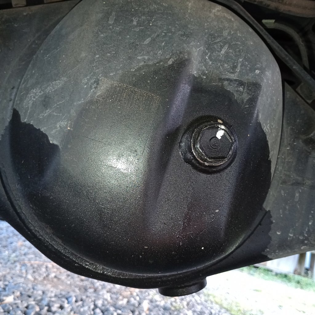

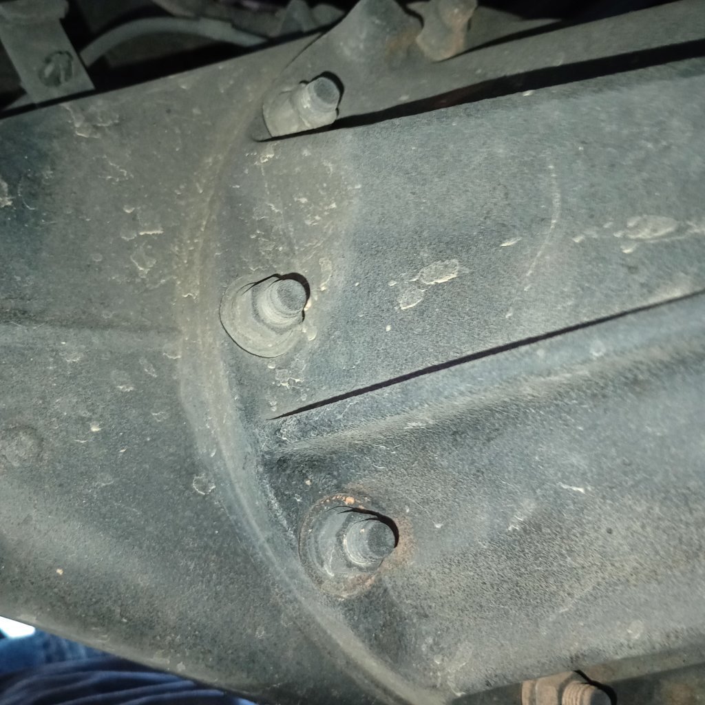

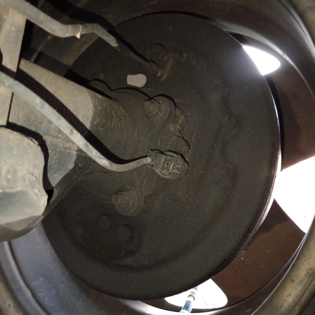

    So Today I had my alternator start whining on me. I replaced it and the whine went away. Went for a test drive to make sure everything was good. When I got back I noticed the my exhaust tips were vibrating hard and was hitting the plastic piece behind the wheel. ( It was idling low when this was happening) Went on another quick drive...came back and the idle was fine. The exhaust wasn't vibrating anymore. While I was under there checking the exhaust out I noticed my rear differential pumpkin was wet. Also noticed the right rear tire area was wet looking also....I have a few pictures of anyone can help me out that would be great.

    yeah- you probably have a gear oil leak at both the fill plug *and* at one of your wheel seals. pull the rear brake drum on the leaking side and see if there is oil all over your brake shoes if so, replace both your rear axle seals and possibly your rear wheel bearing(s) as it is probably contaminated with gear oil. as for the fill plug on the diff, you probably only need a fill plug crush washer.
    and yes- as stated above, check your diff vent. this can cause oil to leak if its plugged.

    Your axle seals are in fact leaking regardless of the outcome of the vent...

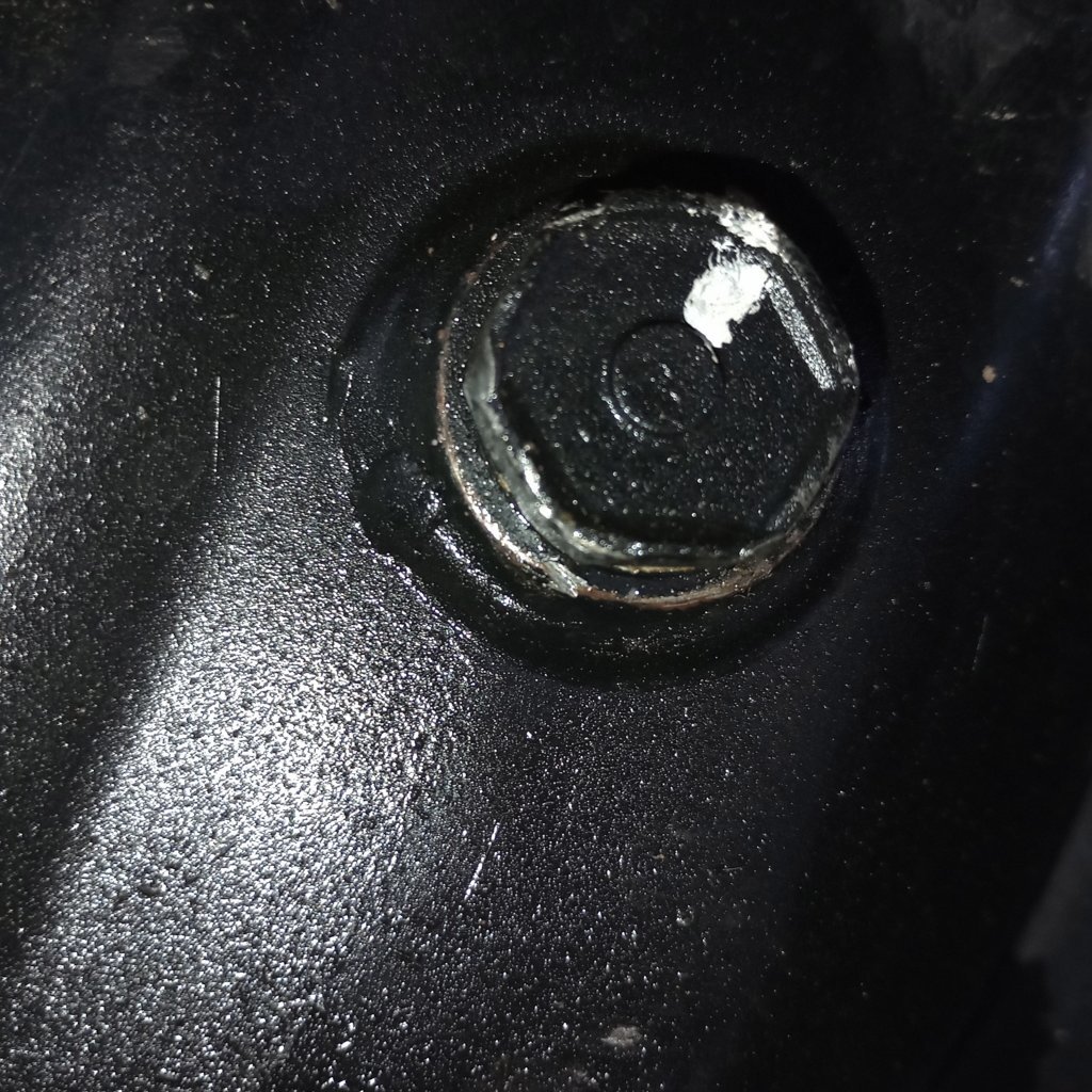

    That fill plug kinda looks like someone took a 12 point socket or wrong size socket along with an impact wrench. It slipped but they kept the trigger pulled. Meaning it’s pretty chewed up and will probably give you a hard time getting it off.

    Someone posted an upgrade to the differential plug.. Lexus part # 90341-24016 .
