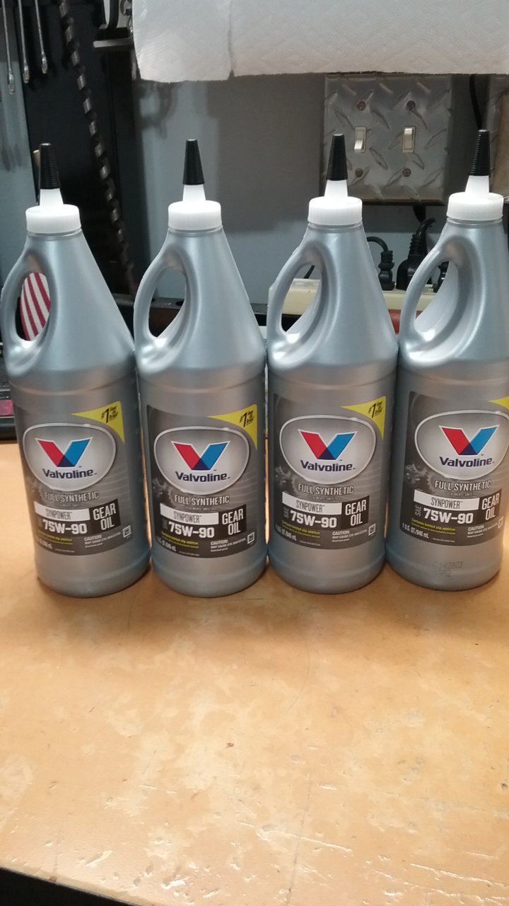

    I did a TON of research on this when mine was due. 75-90 is NOT anywhere near stock and your shitty local dealer probably uses it. Manufacturer recommends 75 for a reason. Redline meets spec, and I *think* Ravenol does. Nothing else does. I spoke to multiple techs who didn't know there was a difference, and two transmission experts who were STUNNED that toyota was using 75-90 valvoline at the dealership. All the guys I respected and trusted said to go with 75. At operating temp that 90 makes a HUGE difference. Don't skimp. Buy the toyota 75 or the redline.
    EDIT: If you do the research you'll find many threads talking about performance of 85/90 weight stuff at high temp and the differences. Many guys sent their stuff in for sampling at chem labs, etc. Redline MT-LV for me
    EDIT2: Just realized OP has a 2nd gen. Not sure what manual recommends. My stuff above is for 3rd gens.
