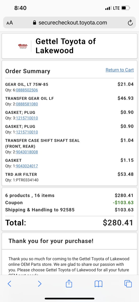

    Did you see the sale last week? $47.00 ($46.93) a quart. I bought two, so I'm covered for a while yet. Wesley Chapel Toyota.
    I got an email this morning saying that mine were shipped. So it wasn't a scam.
    "Thank you for shopping with Wesley Chapel Toyota
    Your order number is #9xxxxx3. The VIN provided at checkout is 5TF-- --30.
    ALERT: Not all products fit this VIN.
    To check the status of your order at any time, please click here. For questions about your order please call us at (813) 473-7568, or reply to this email.
    Order Contents:
    P/N: 08885-81080
    Quantity: 2
    Price Each: $46.93
    Description: TRANSFER GEAR OIL LF
    Order Summary:
    1 products , 2 items: $93.86"
