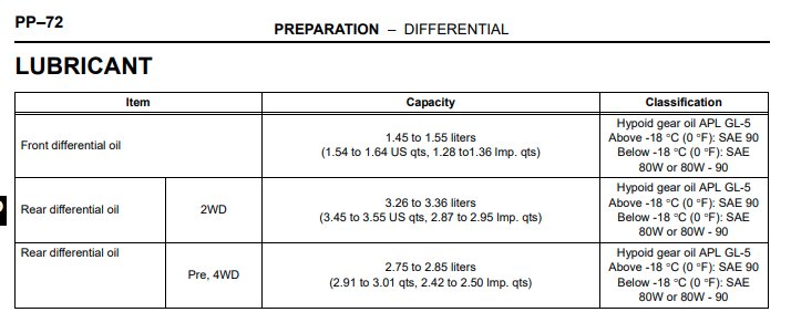

    22Coma6MT
    22Coma6MT Well-Known Member
    Jul 7, 2022
    #400898
    697
    2022 TRD Sport AC 6MT
    I do not recognize the chart you posted. It does not seem like it is for a 3rd Gen. For example, a rear diff in a 4WD 3rd Gen will take 4-4.2 quarts depending on model. I am not aware of any exceptions to this.
    Edit: I now see there are diffs that take less than 4 quarts...? My bad. I did not think there were that many variations.
    As for weight or viscosity, toyota recommends 75W-85 GL5 for both front and rear diffs in a 3rd Gen but many of us use 75W-90 because it is easier to find.
    I do not know the answers to your other questions.

    Ah. My bad, I did not realize this was a third gen thread. This is a chart from a 2nd gen service manual.
