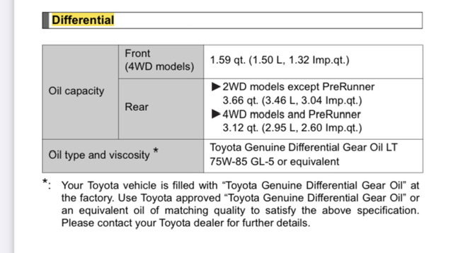

    Good day. I have a situation where I can’t figure out which fluid to use on my Tacoma. I have a 2013 Tacoma pre runner TRD sport model. I’ve checked this forum up and down and I just got confused and my local Toyota stealerships were trying their hardest to get me in to change the fluid. Does anyone have an answer for which fluid am I suppose to use and if I need the additive for it? Also which one does everyone recommend?

    It will say in your owners manual...

    Check your owners manual but I believe you do not need the LSD additive. Only the older 2nd gen trucks have a mechanical LSD

    2005-2008 with limited slip (TRD Sport) needed the additive. Yours does not.

    Pick a 75w90 fluid of your choice and be done. Your rig requires nothing extra or special
