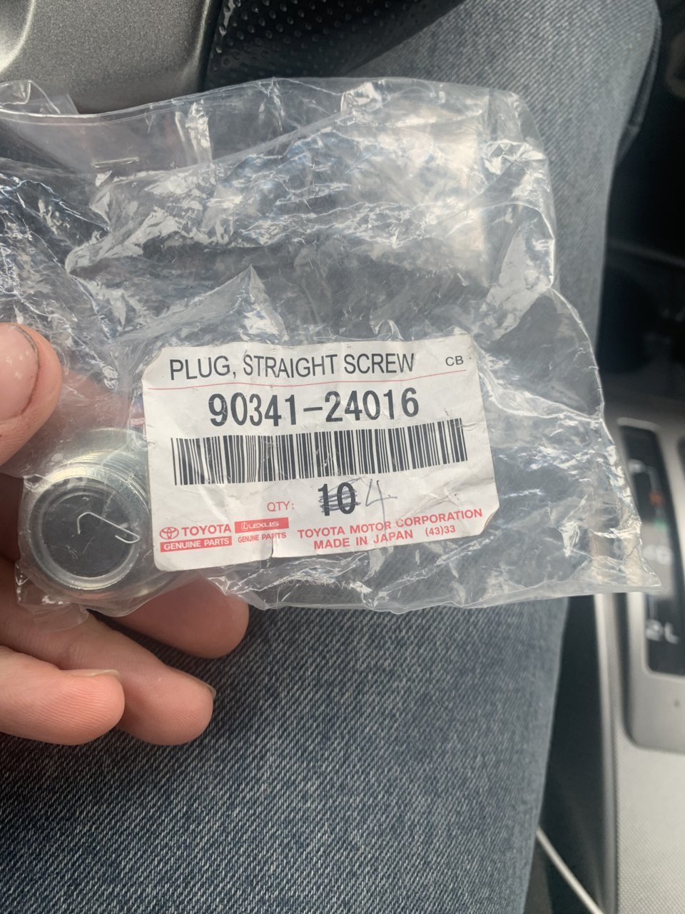

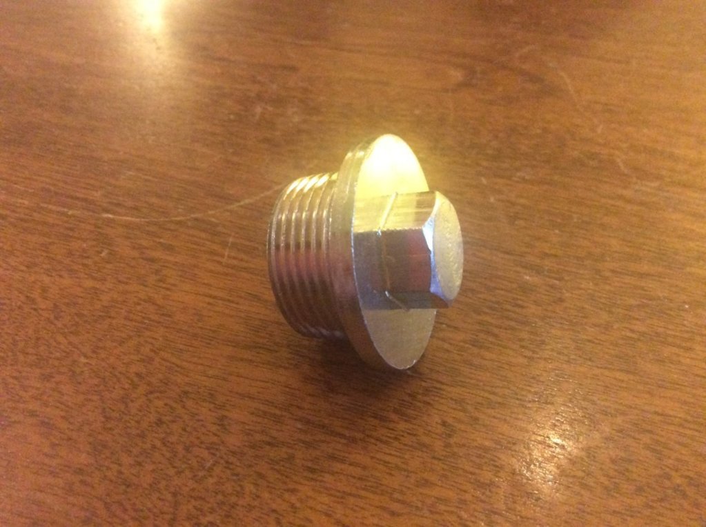

    OP get this for your front diff, as the hex style/allen key style drain bolt that our trucks come with stock will strip in time, not if but when, buy this now and replace it when you finish the job. It has a 14 mm nut end as opposed to the 10 mm hex key end. You can do the fill plug too if you want, different part number, but the torque spec is less and it is not known for stripping.
    This is for Lexus’ but it fits our trucks perfectly.

  14. Jul 14, 2023 at 12:17 PM

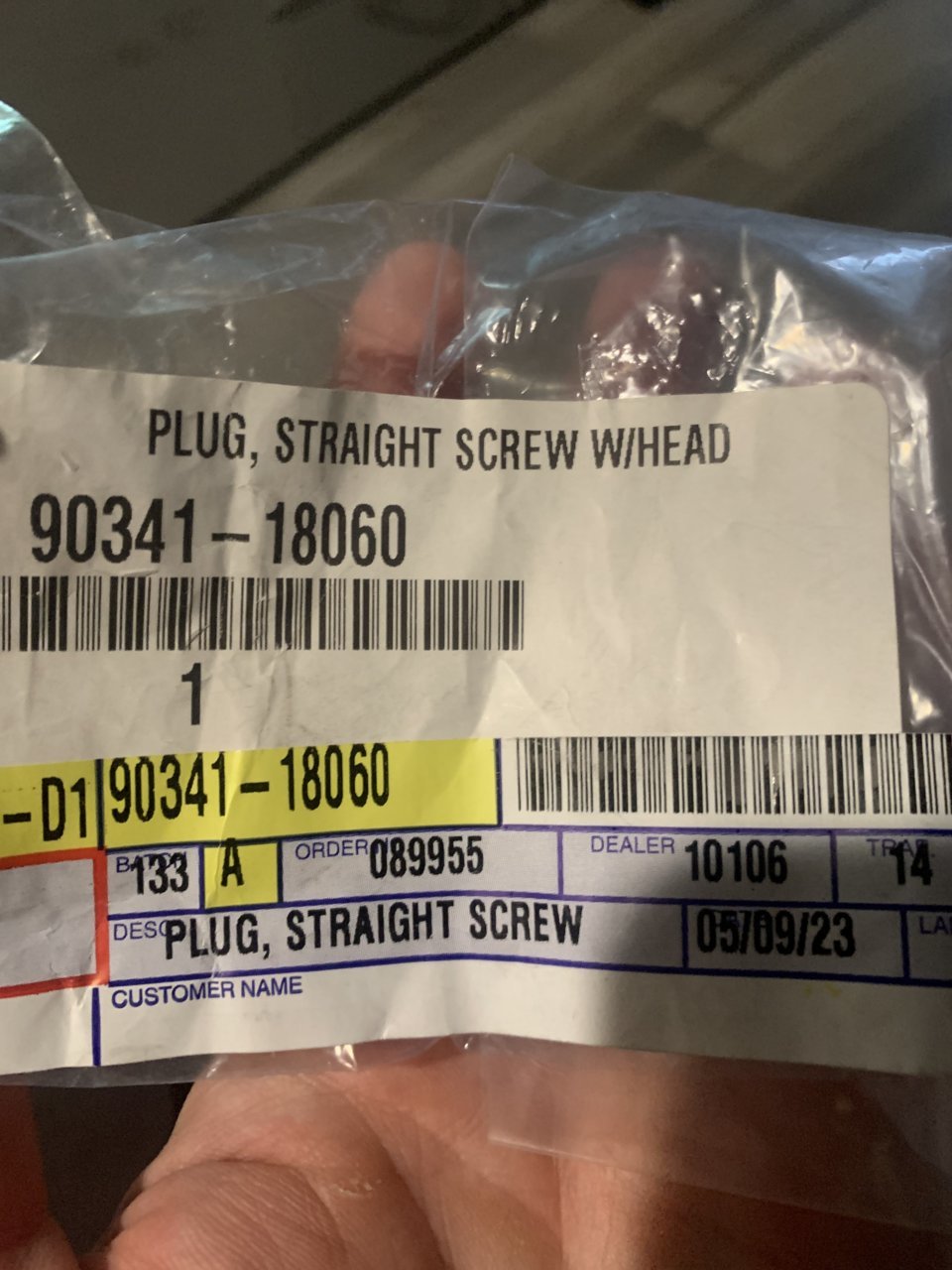

    what is the part number for the fill plug

    you mentioned that was for the drain plug and that the fill has a different part number.

    Oh right, one moment while I dig the fill plug number out.

    Lexus front diff fill plug with nut end.
