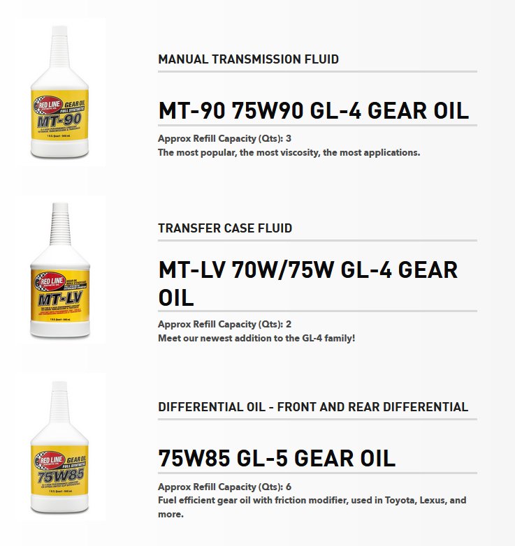

    This is my exact fluids of choice also! Great minds...

    Got 2 quart bottles or RedLine MT-LV off Amazon for $25 each because the book says you need 1.1 quarts but could probably just get one.
    A gasket set is available on amazon for $5.99. I was at just under $120 for the materials to do it.

    O'Reily has free shipping and 15% off so I ordered all Red Line fluids today for my change. $239.99 to my door.
