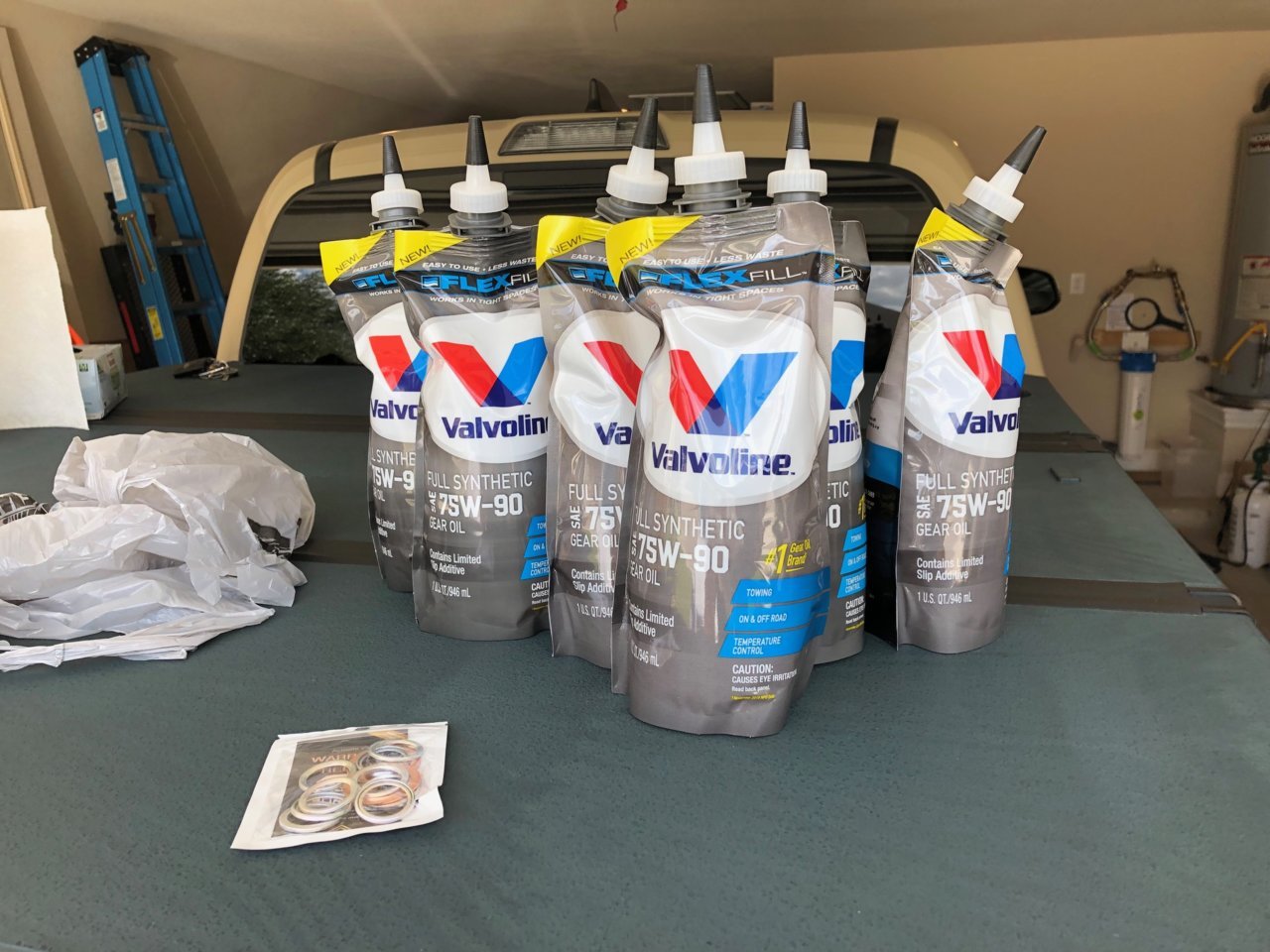

    I just did mine a couple of weeks ago.
    I used Valvoline synthetic 75W90 in the easy to use 1 qt squeeze bags.
    Order some crush washers from Amazon make sure you have the right hex driver for the front diff and its easier than an oil change.

    +1 for the squeeze bags! No pump required to drain the entire quart.

    For the differentials you will need 6 qts. 4 for the rear and 1 and a fraction for the front.

    Less junk in the garage, and actually easier to use than a pump.
