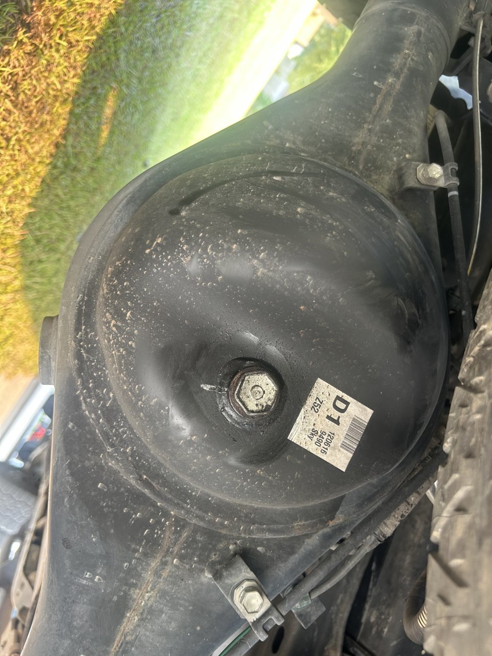

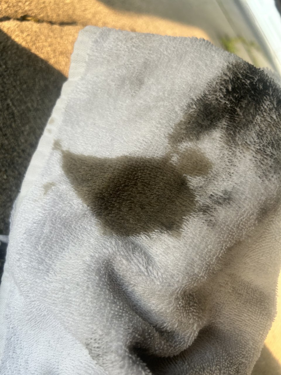

    See title. I have been hearing a light rumble/ground from the rear for a couple of days but haven’t crawled under until now. Thought it was the parking brake dragging but now I realize it could be this. Not even visibly dripping so I don’t think it would have lost too much fluid. Next step is to drain the oil, but also looking for other suggestions

    Check the level first before draining to see if you can even touch it through the fil hole.. Measure what comes out to get an idea on how much its been low.

    I would put the rear diff on jack stands. Put the trans in neutral with the park brake off and check for pinion play. Grab a hold of the pinion and try to move it up and down. It should not have any play. Next rotate the pinion back and forth slightly, to see if pinion to ring hear play is excessive. There should be a small amount. Next, I would rotate the pinion and feel if there is any roughness in the assembly. It should spin smoothly with resistance from the weight of the wheels and axles. Next, remove the fill plug and see if the there is oil just under the opening of the plug hole. If there is, then the fluid level is alright. Next you can drain the fluid and filter the fluid through a cloth or heavy duty paper towel. Look for metal in the filter media. Also look for heavy metal sheen in the fluid. If everything checks out then refill and see if the noise continues or worsens.
    It is normal for a diffential to be hot to the touch after driving a while. And it isn't uncommon for the plugs to sweat fluid. The noise, if it is from the diff is something that may or may not be an issue of concern.

    I can't really see the seeping, so I'm not sure there is an issue except maybe snug up the plug a little. Better yet: check it when it's -cold- and install a new fill-plug gasket when you put it back together. If it seeps a little when it's cold, wait until it's a drip and install the plug. Spray the area with brake-kleen and monitor it. Don't remove the drain plug until you verify the fill-plug will come out. If there are major issues with the diff: the magnetic drain plug will indicate it. (A little metallic fuzz is normal.)
    Warm/hot diff is normal: That's why it requires 75W90 oil. :thumbsup:

    I don’t see your leak?
    That looks like old gear oil with road grim.
    Likes it’s been there awhile.
    Gear oil sticks around.
    I usually take Brake/Carb cleaner and spay the diff off after I refill.

    I should have taken a picture when I first crawled under there. I had already wiped the grime and spot of oil around from the fill but I agree on that it wasnt very much oil on the diff. Which makes me feel a little better
