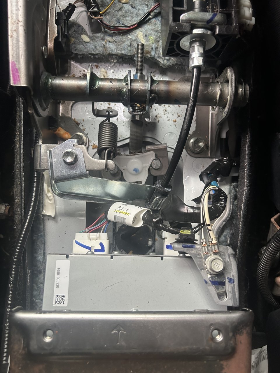

  15. Jul 19, 2023 at 4:30 PM
    #35
    tpgillikin3
    tpgillikin3 [OP] Well-Known Member
    Feb 8, 2021
    #355463
    64
    Timothy
    Beaufort, NC
    2017 Super White TRD Off-Road DCSB 4x4
    Camper Shell, Decked System
    This is what my parking brake assembly looks like under the center console. Is there a reason why the two cables would be misaligned? Thinking the passenger side not releasing as far forward as the drivers side could mean that the passenger side is dragging
    *Update: the equalizer bar appears to be uneven and doesn’t hold its position after changing it manually and actuating the parking brake a few times

  16. Jul 19, 2023 at 6:03 PM
    #36
    AM6217
    AM6217 Well-Known Member
    Aug 3, 2021
    #373030
    1,043
    2021 SR-5 DCSB Silver metallic
    Put it on some jack stands. Strip the tires, and see if both drums come off easily. Perhaps the passenger will be more difficult indicating you may have messed up the parking brake. Take a pic of both sides to compare.
