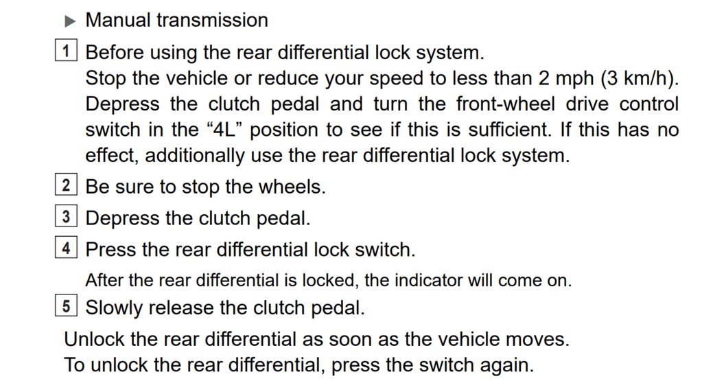

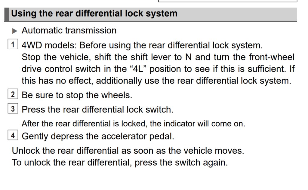

    Is there a special procedure to lock the diff? Today I was in 4low and pushed the button and the red light just kept flashing. Tried driving forward and reverse, but never locked.
    Am I doing it wrong?

    Yes, there is a procedure.
