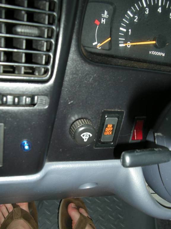

    An air locker or electric locker allow you to select loocking diff or not. it is great for the street. when off road just hit a button and you are locked. the air locker requires on board air(compressor and tank usually). elocker just a wire to the diff. if offraoding these air or electric lines could be damaged and locker could stop working. a full time locker does not have these issues but is not really great on the street. it will work but has some drawbacks.

    i wish my truck had that button... nice flip flops by the way:D

    Mine is a TRD and does not have that button.
