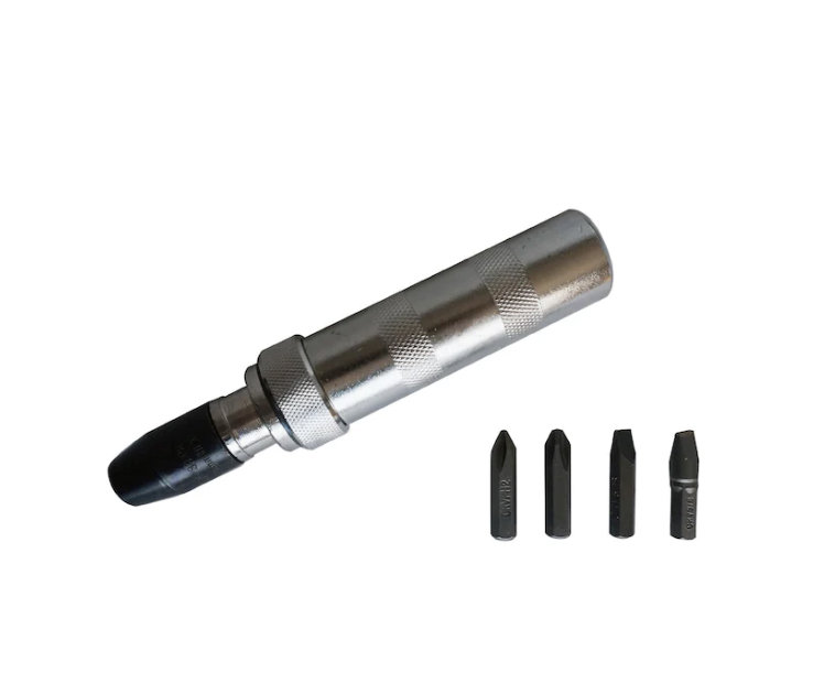

    Also, that front diff drain bolt can be a BEAR to get off. I use a 10mm Allen socket and impact screw driver.
    Most are 3/8” drive. So you’ll need a 3/8 drive socket style 10mm
    Do a few little taps to seat the 10mm and then a good solid SMACK. B2D61CA2-4D31-46FF-92DA-4DCD823EA549.jpg

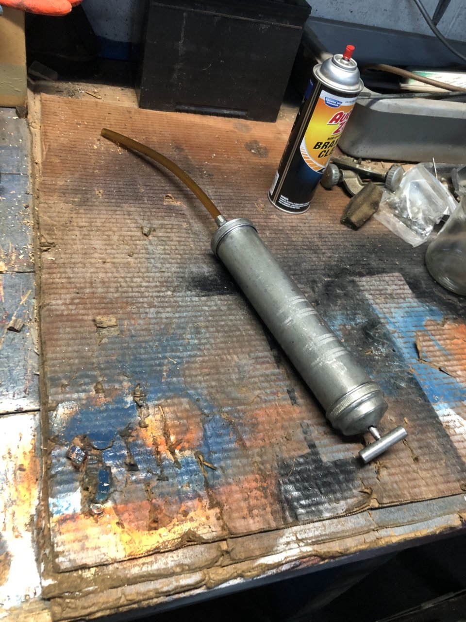

    I got a syringe style pump like you show... way better than the bottles. But it was still quite messy and clumsy. It's one of those 3-handed tools. And it required frequent refilling to do all 6qts on all three cases.
    This guy's video was one of the helpful ones I used to educate myself on this job. About halfway through he starts filling with a much cleaner looking pump that is like a hand soap dispenser bottle. The pump sits atop what looks like a 2qt jug of gear oil.
    I'll see if I can track down where he got that solution. It looks more convenient than the low capacity syringe style.
