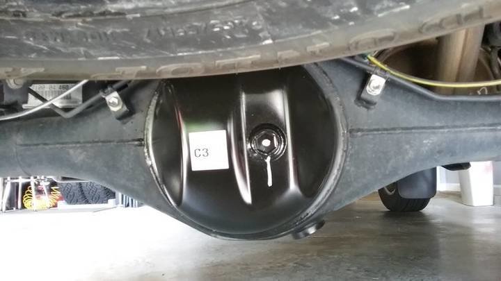

    Did mine at 30k. Spent $2 at the dealer for the washers.
    Gratuitous pix. Nothing further to add. :oops:
