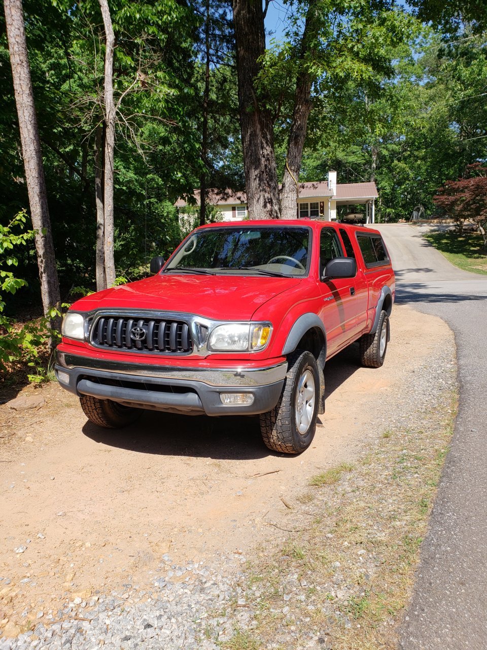

    Hey guys. First post and recent 1st gen tacoma buyer! I'm looking to do serious maintenance and moderate upgrades to start out. It is my daily driver so I dont want to go nuts. I do want to change my diff. Oil though being that it's a new to me truck. Does anyone have suggestions for oil and or begginer mods? I'm fairly mechanically inclined and enjoy mechanics so dont hold back. 20180513_160801.jpg
