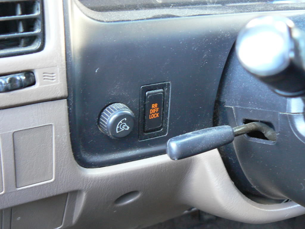

    If you have a button to the left of your steering column that says "RR DIFF LOCK" then you have a TRD Package with an electronic rear locking differential.
    If there's nothing there, you have an open diff.
    Don't let these people from a different generation Tacoma confuse you. They happen to be in the wrong section as their vehicle won't exactly have the same options as yours.

    It's a stick that says 4l 4h N and 2h. Right next to my original stick

    No.
    Left of steering column.
    Read the post.

    It looks like this buddy.
