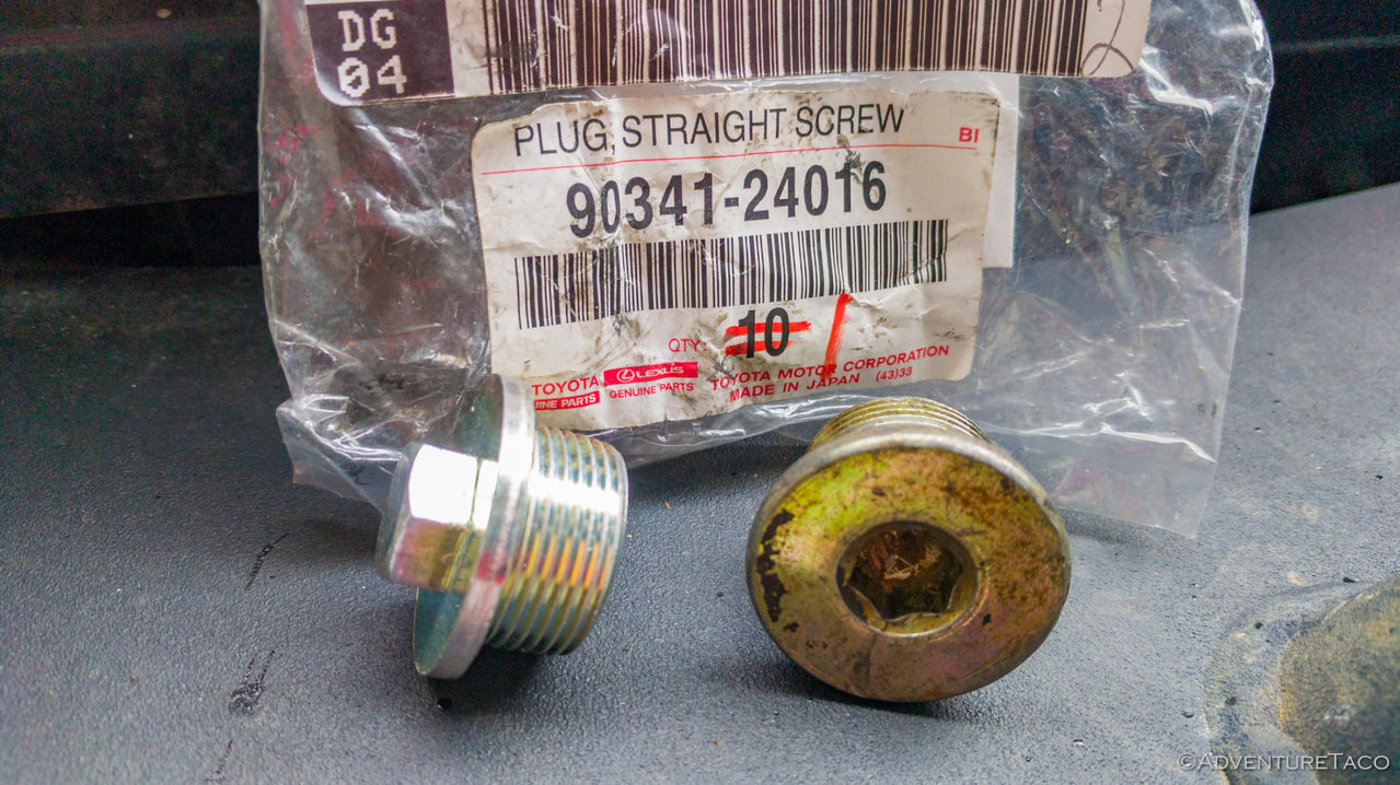

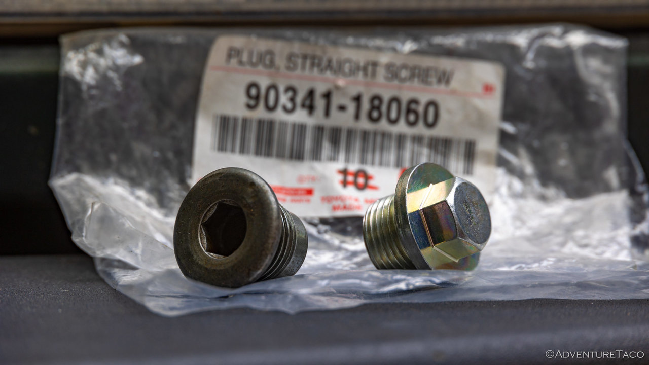

    Be careful removing the drain and fill plugs if they are the hex style, the hex style tend to strip out , not the plug but where the hex section is.
    These can be replaced with Lexus drain plugs that have a bolt style head instead

    Got part numbers for those Lexus drain plugs? i don't much care for the OEM tacoma ones, because I have found they strip pretty easy.

    Go to the first page.
    I like when people suggest other parts but don't provide part numbers :rofl:

    Thanks, sorry i missed it, was skimming through pretty quickly. I'm assuming same fill and drain plugs will work in both front and rear dif?

    Depending on the year they are both different sizes.
