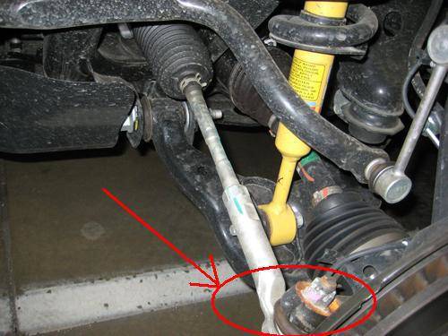

    Ok, so I'm a noob, but is this the differential and is this where I install the diff drop spacer?

    i do believe thats the tie rod for turning....the diff spacer goes under the truck and drops the 2 diff bolts down an inch to reduce that angle
    i would post a pic, but the allpro skidplate covers it all up underneath there

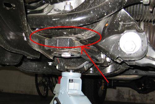

    Is this where I put the diff drop? it's above the skid plate...

    follow the differential to where it bolts to the frame. there are only 2 bolts. one on each side. thats where the 2 bolts and spacers go

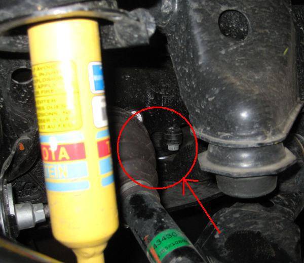

    This is where the spacer goes, right?

    thats it...and by ur other post, ur getting it aligned and all, so i'm guessing ur already done w/ this part...lol

    Yep, got it! Once I found this, I was 99% sure that it was right. I just posted that note and picture to get some peace of mind. But, when I didn't get a response after about 20 minutes, I just went ahead with it.
    This is exactly why I wanted to do it. I wasn't going to put a lift on at all until I started reading this forum and found out what was involved. It's really not hard at all, it just takes time. Took me and my buddy about 10 hours, but we took our time and goofed around a bit...
    I was pretty nervous about doing it simply because I never had before and the fact that the truck is brand new! I didn't want to screw it up. But, I took my time and double and triple checked everything. Torqued down everything necessary per the specs and once I got the tires on, nothing was rubbing, clicking or knocking. Well, except that an inner weight on the right front wheel would hit the sway bar when fully locked to the left. But, when I got the new tires today, I mentioned it and they put lower profile weights on, so no more problems!
    So thanks to everyone for the help! A build thread will be coming later today with pictures...
