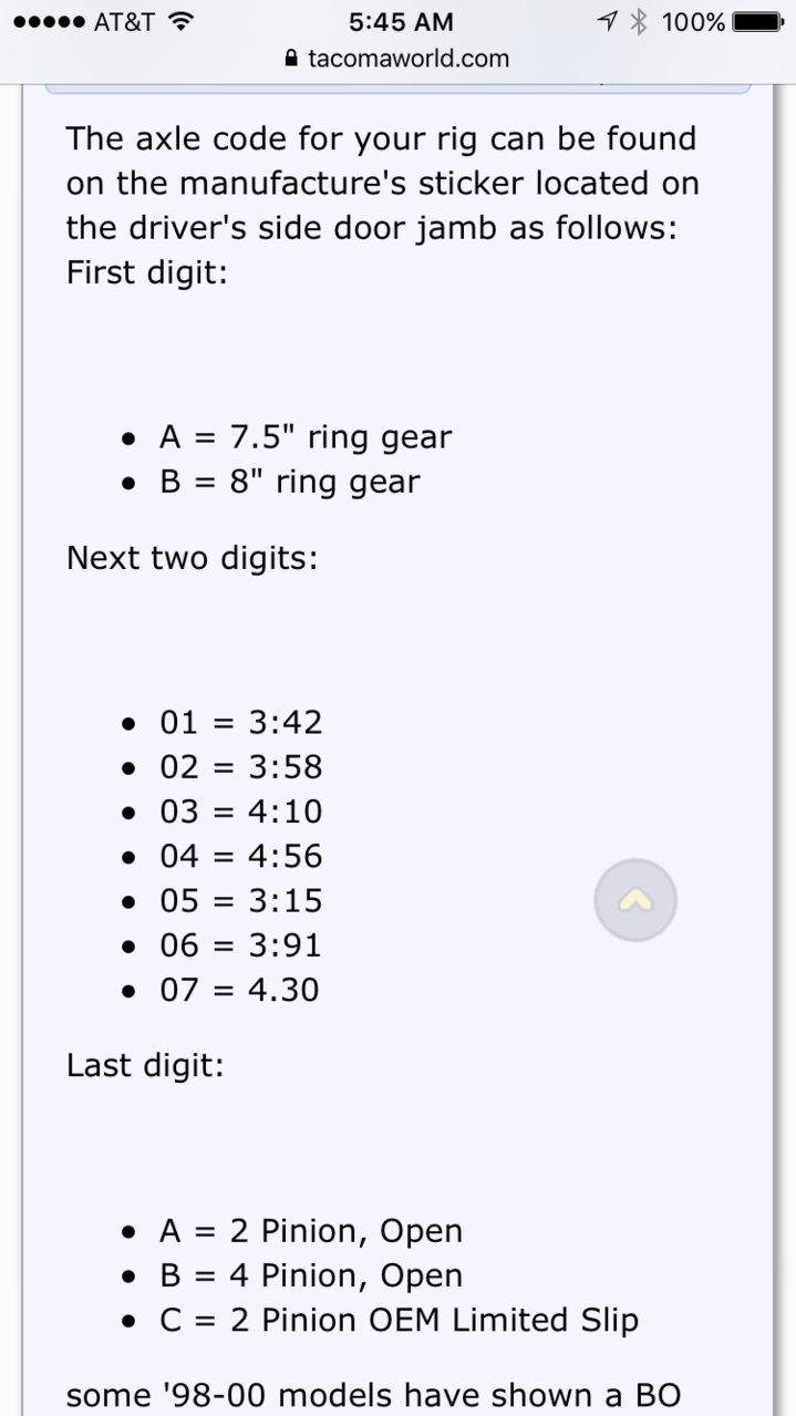

    Look on the inside of the driver’s door jamb area for your code. There should be a sticker there with different info

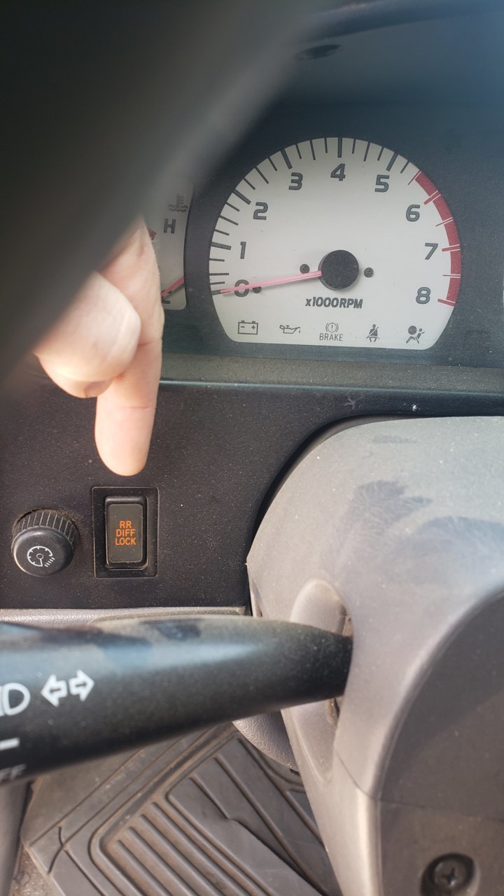

    If the truck is, in fact, stock... and the question is "do I have a locker?"
    Do you have this button right here?
    If the answer is yes... you have a locker.
    If the answer is no... you do not have a locker.
    On an 02 double cab... if you have a true TRD package, you will have that button, white guage faces, and the stock wheels would have looked like this.

    Okay guys ! I went home and looked the axle code is B03A therefore I have an open diff !
    Slightly disappointed but nothing a little healthy weight in the back cant remedy, I was hoping for a limited rather than open because I'm up in michigan and wondering in case I get stuck.. thank you guys all a lot for the help ! And on that note is there any way of knowing the TRD Off Road is authentic or not ? I'll add a few photos too while I'm at it.. once again thanks yall!
