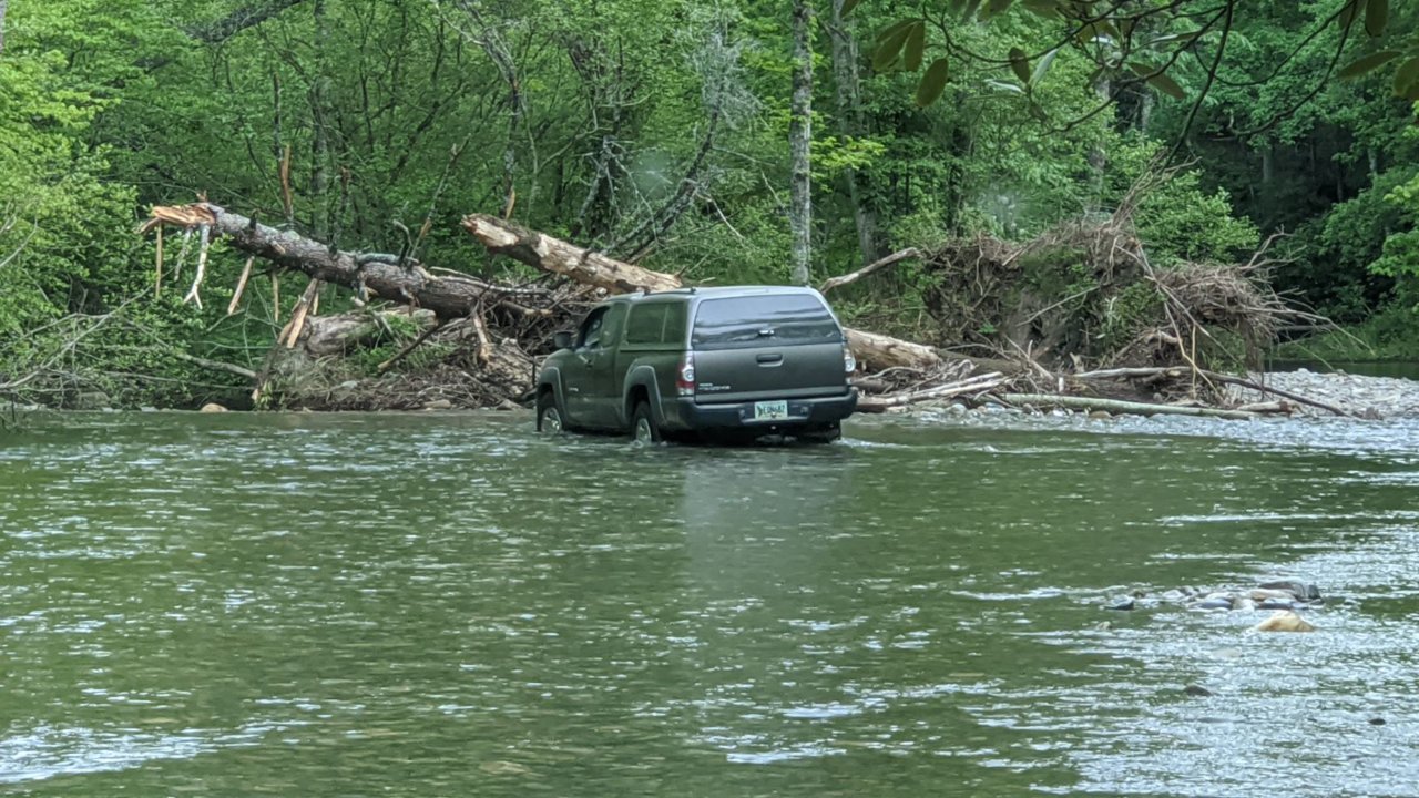

    68F6FB6E-9229-40BC-8FF2-7A6C7B4DCF0B.jpg I have an 09 Tacoma 4x4 with the 4 cyl and the 5 speed...
    ... and a couple months ago I drove it up a river with out doing the diff breather mod...
    ... I know, I know
    And now the rear diff is making sexy noise!
    So my question is: will installing a Detroit trutrac fix this? :):)
    Or does water in the diff trash more than that?

    Was the rear diff underwater for a prolonged period of time? All the way completely covered? By the looks of that pic I'd be surprised if you got any water in it at all. Maybe brakes are making the noise?

    It wasn’t that deep in the picture- but the rest was pretty deep. It only makes noise when I’m on the gas

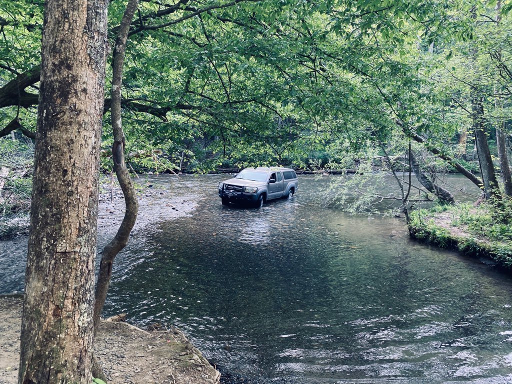

  13. Aug 21, 2020 at 8:13 PM
    Jacob06
    Jacob06 [OP] Well-Known Member
    Jun 21, 2018
    #257094
    331
    Atlanta
    2024 TRDOR 6MT
    This was May 17- I’ve probably drove 5000 miles
