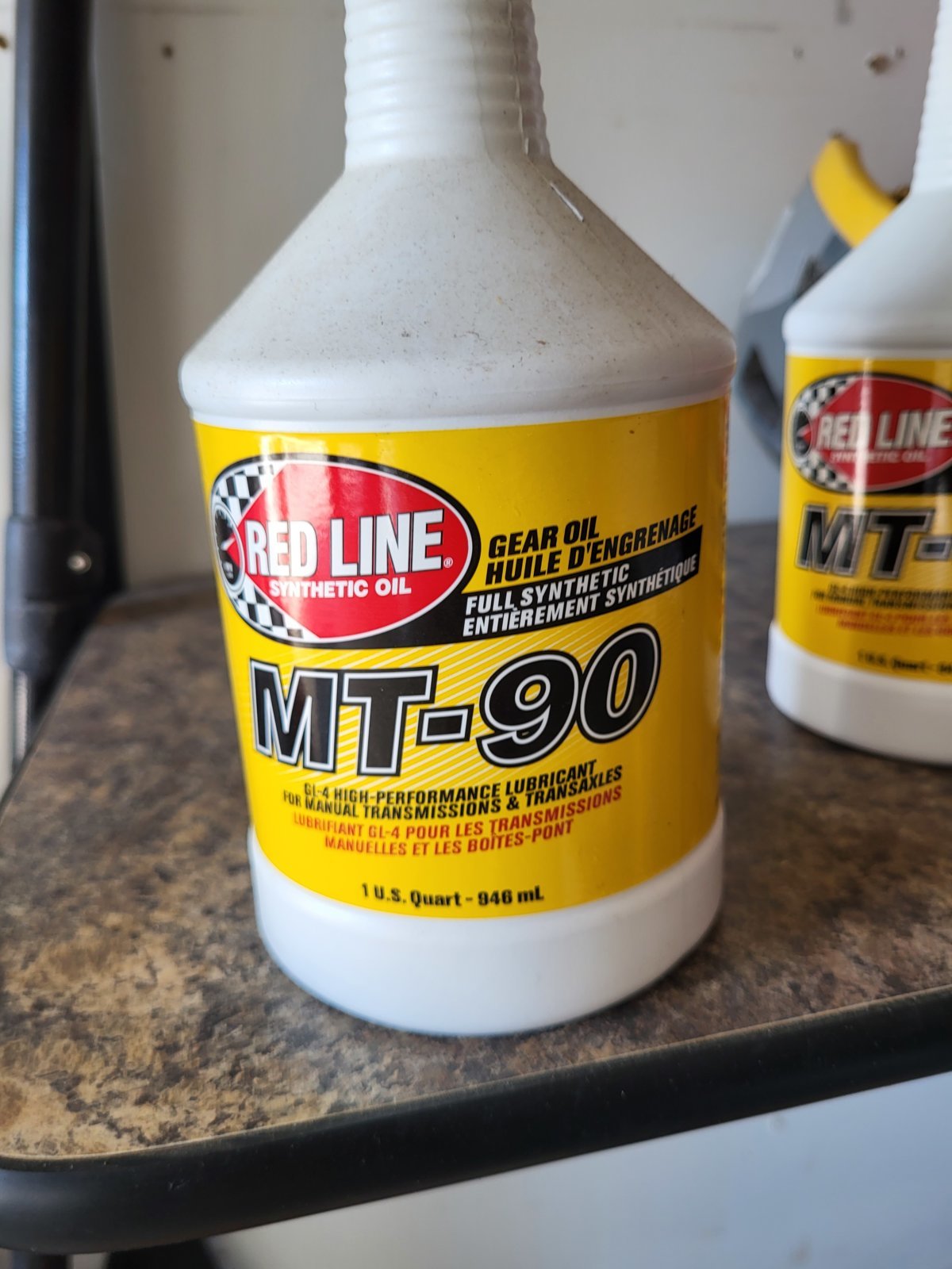

    Can I use this stuff in the t case and diffs of my 2015? I had it leftover from my first gen. It's gl4.

    Absolutely, but in my opinion it's overkill for the diffs. I'd use it in the transfer case and buy something a little less expensive for the diffs.
    It will work just fine.
