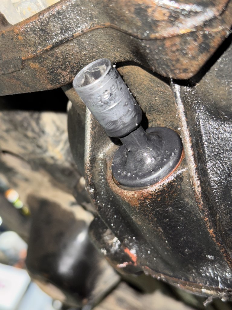

    I believe the front differential remained the same in the 3rd gens. As an even stronger alternative to the Lexus plug for the front diff (the most problematic of our plugs), you can weld a 10mm socket onto the plug.
