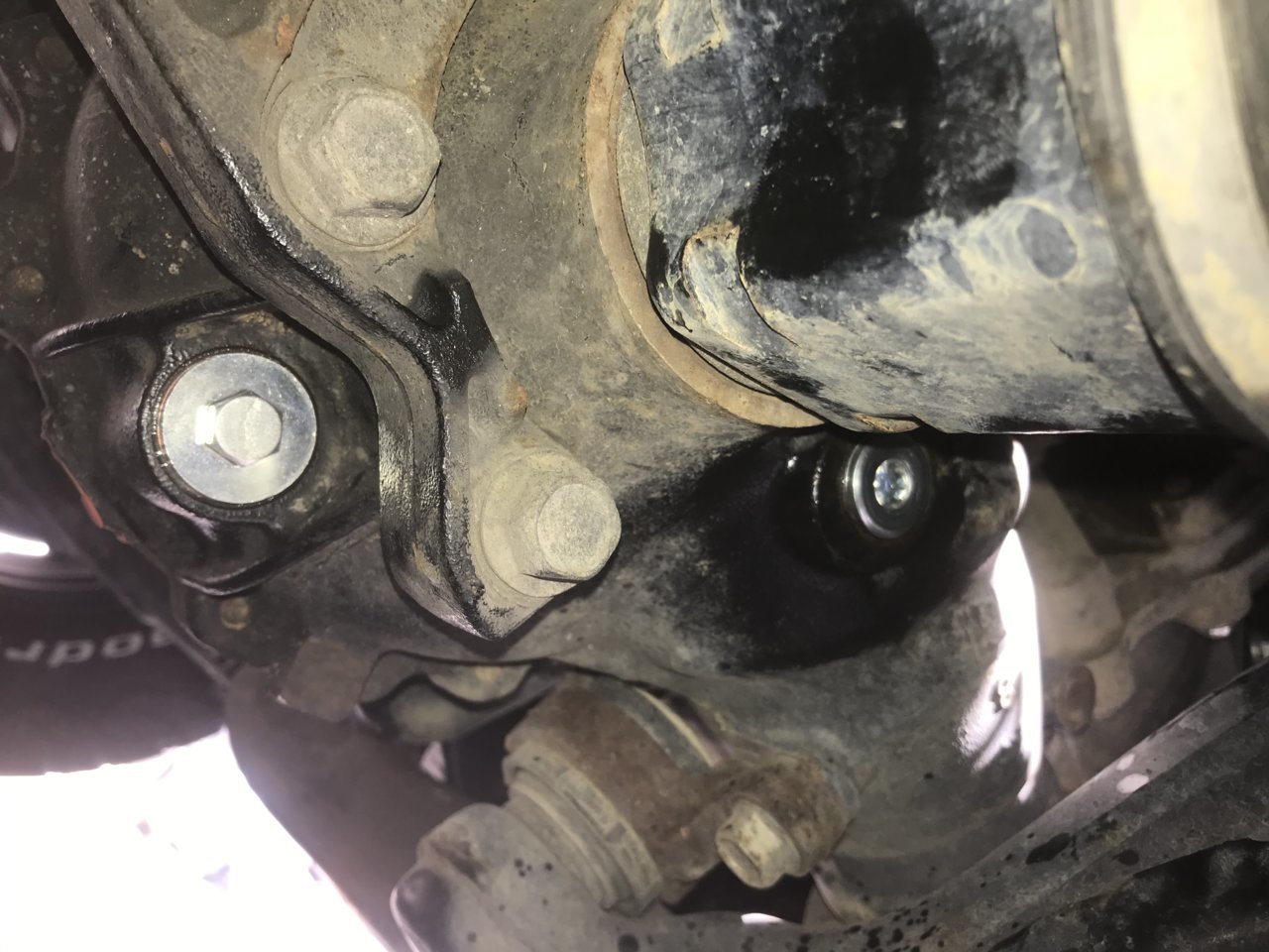

    Yes, also make sure you take off the fill plug before the drain, you don’t want to be in a situation where you have a frozen fill plug and an empty diff. The front diff 10mm hex drain plug has given people some trouble and once people, including me, get it off they replace with a Lexus drain plug (90341-24016).
