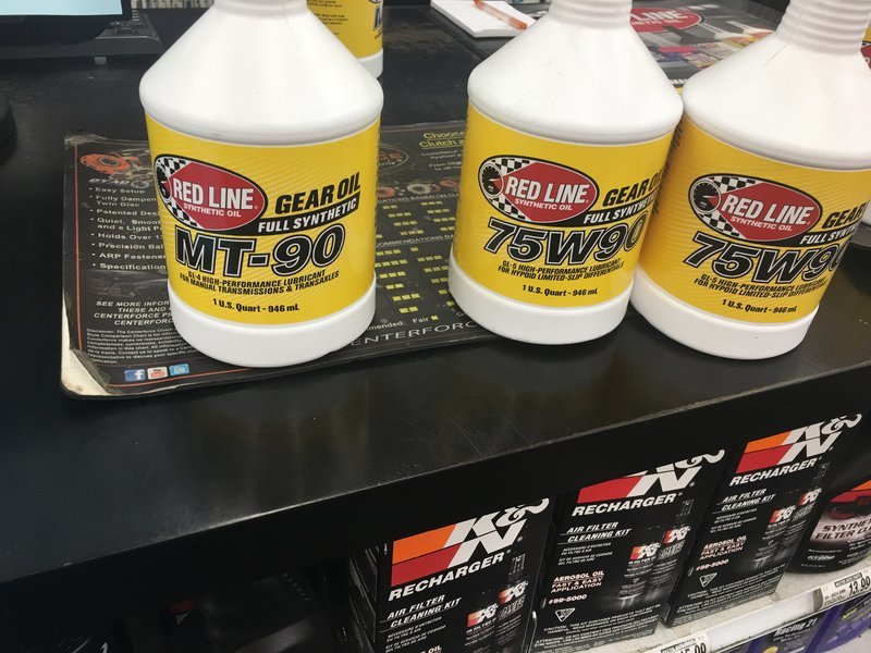

  9. Dec 3, 2016 at 10:30 AM
    Markc1024
    Markc1024 Well-Known Member
    Sep 17, 2015
    #164491
    546
    You should be golden now!
