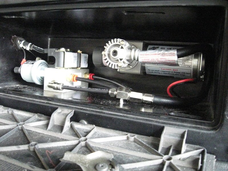

    Install of Air Lift pump and valves (independent right/left inflate) in one of the bed storage containers.
    Just a thought. Another is behind the bed liner which is popular.

    Looks great, I'm leaning towards this position. Did you have enough material with the kit?

    295
    2006 SR5 4X4 AC 4.0 Auto
    everything except power cable.
