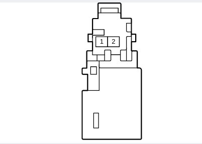

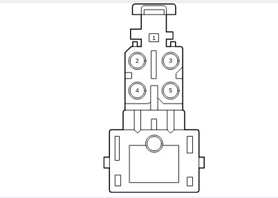

    You wouldn't remember if you saw 2x extra unused connectors up there when you pulled off the headliner? I've been researching a lot into the trailer cam system and it seems like aside from the wireless camera itself, the only other thing that's needed are those two sharkfins which hook up to a "Trailer Camera ECU" - which I believe is actually the same telematics control box that's used for the rearview digital camera as well. My gut tells me that the harness is already in the truck for those extra antennas, at least based on the TIS drawings, but wanted to know if you remember seeing them? Just before I rip apart my headliner and backseats, lol.
  17. Jul 17, 2024 at 10:30 PM
    #37
    Gurvy522
    Gurvy522 Well-Known Member
    Apr 19, 2024
    #448263
    46
    2024 Tacoma Limited / Wind Chill Pearl
    The connectors should look something like this. Brown in color.
