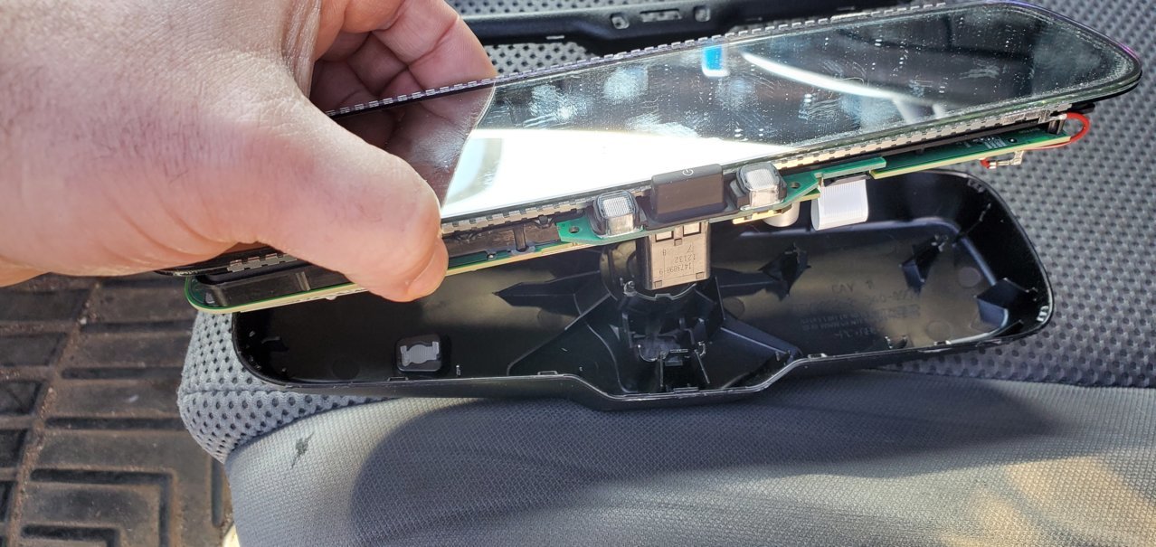

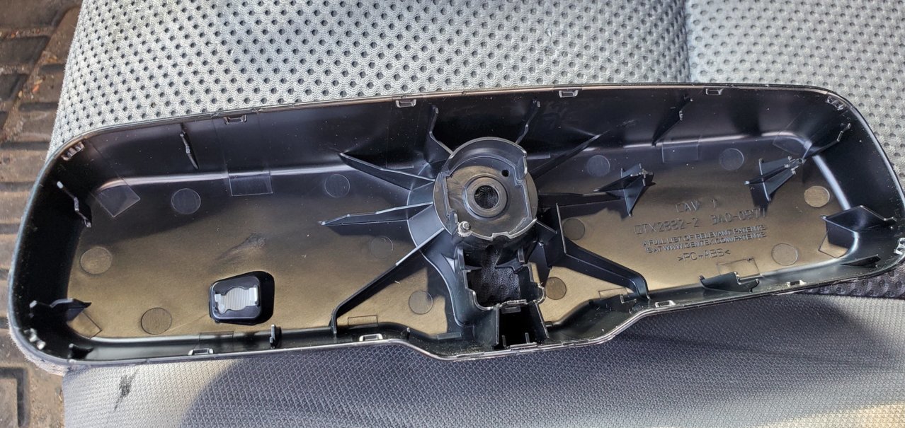

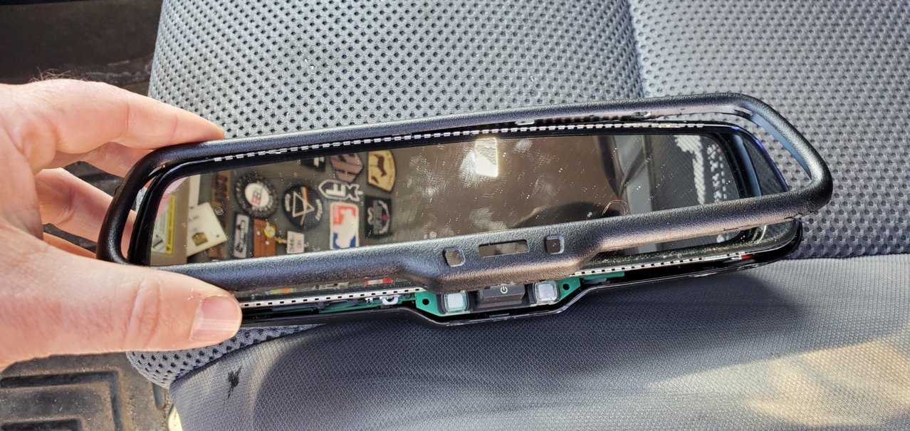

    Here is what I did. First I took apart the oem rearview mirror...
    The back of the oem has the mounting point to the "ball" that attaches to the rearview mirror itself. I unscrewed it and took it off the mirror.

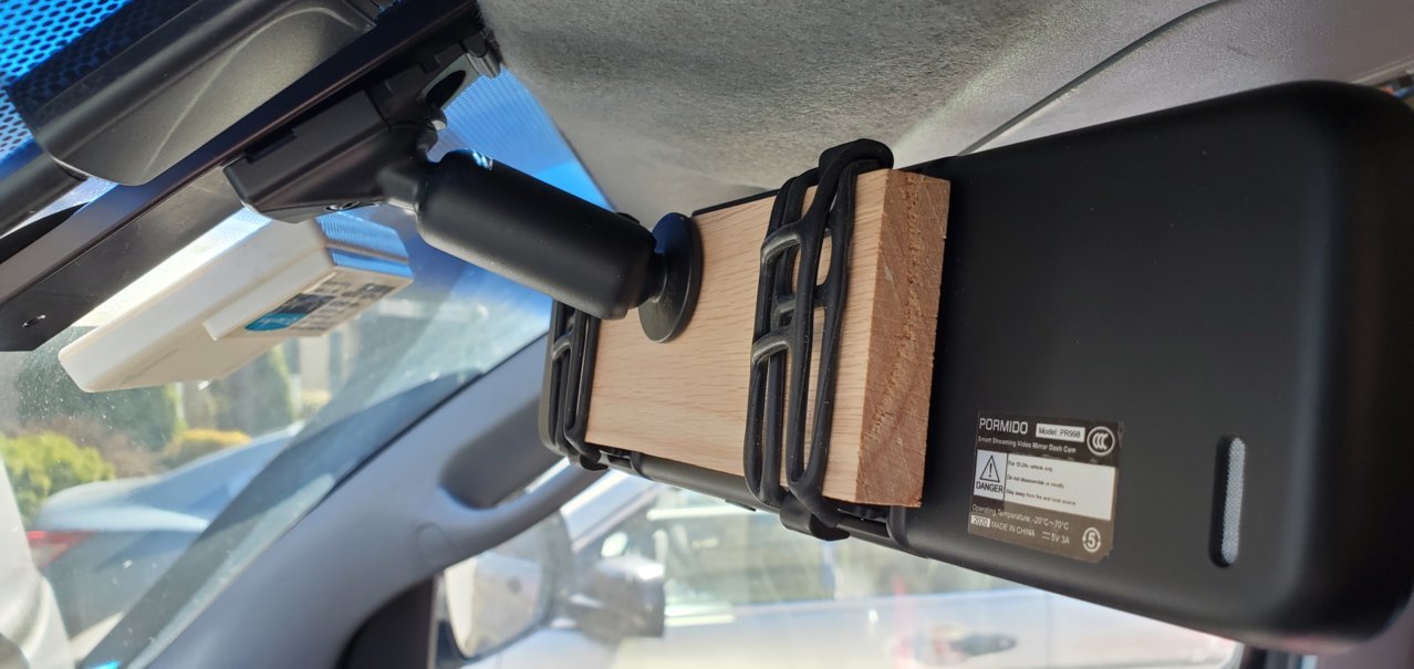

    Then I cut a piece of oak trim 1/2" thick by 6 inches long by 2 1/4" wide and attached the oem piece that attaches to the mirror by drilling a hole in it and mounting it directly to it.

    Thats awesome. I started reading it "wow, he is custom building the dashcam into the OEM mirror" then I got to the end where it strapped to a block of wood.

    The block of wood is small and really doesn't show. I know that they sell mounting harnesses on Amazon that do the same thing but the are shipped in 30 days and I got impatient lol. From the front, you really can't see it and it doesn't stick out as much as if I were attaching it to the oem mirror.

    Honestly, the hardest part was taking apart the oem mirror. There was no diagram or directions to follow. I had no clue if it was glued or screwed. I basically told myself "well....if I break it, I break it." Thank God that didn't happen lol. You have to take something thin and stout and pry off the front trim piece tab by tab and eventually it comes off. It is the only way to get off the attachment to your windshield off your mirror.

    Nice! At first I thought you put the new mirror in the OEM housing. But you just removed, then attached to the wood?
    Nice idea! I may go that route?? I would have to paint that wood though :thumbsup:

    Yup, just removed the housing from the mounting point and attached the wood. I literally just did this yesterday so I too am going to paint it black. I didn't have time and wanted to make sure I had a "rearview" mirror to see out of. The digital screen can be used as a regular mirror as well when the screen is off. The reason why I went with the one I chose was because the front mounting cam can be placed in a separate location and it is not fixed to the mirror itself.
