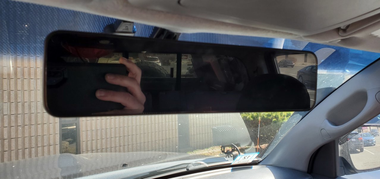

    The vantop camera comes with everything you need. I bought the USB power so I didn't have to plug it into any of the open facing ports in the cab.
    I had the anytime front and rear camera prior to the vantop, those feed to my entune unit, they serve a different purpose. The vantop is nice for full visibility front & back, the other cameras offer additional viewing angles on trails as well.

    WOW! That's a lead time for sure!
    When yours comes in, would you take off the OEM arm or just mount the back panel to the OEM arm?
    Edit: How do you power your mirror? I've seen some plug into the ports center of the dash, and have seen where you run wires to a fuse box?

    I actually didn't order it.....I just came up with this solution instead and I am happy with it. In with regards to powering it, I haven't run the wires as of yet, but I placed a power distribution block underneath my driver's seat. I am going to run the power cord up into my roof lining, across to the driverside A-pillar, and down under my dash. I am going to get a 12 volt socket like this:
    https://www.amazon.com/gp/aw/d/B07H1MGWFN/ref=ox_sc_act_image_2?smid=A16CVBF2I7CB1S
    and run it from my power distribution block that is underneath my seat so it always has power going to it (mine will run and record on a loop even when the truck is parked in case it gets hit when I have it parked) and the screen has an On/Off button underneath it so even though the screen will be off, it will still record. I have an X2 power agm battery so I am not worried about battery drain.

    That's too cool. So you're essentially relocating your usb/cigarette plug to keep all the wiring clean? This eliminates having to run to your battery, and also allows you to use for other accessories that will need power? Sorry for the questions, just trying to learn a few things, and get some ideas for later down the road. I know my truck has the outlet in the bed, but I may try to do something similar in the bed later down the road

    No problem at all....ask away. I ran 2 8awg wires from the battery to positive and negative distribution blocks from the very beginning. I did this because I have things like a cb radio, and 2 separate USB charging plugs for the back seat so both of my kids can plug in their tablets or phones. It just made things easier that way.

    That was a smart move. Do it all once, and now you have everything inside the cab. Makes it much easier.
    Did you just run the wires from the battery through the cab and under the carpet? Is moving the liner and a-frame pillar section difficult? Did you use any special tools to snap the plastic piece free from the pillar?

    I have had another truck before I bought this one and learned to prepare for things ahead of future mods. You can tuck the wire up into the headliner and the A-Pillar is just 2 10mm bolts and it pulls right off. I ran the wires through the hole in the firewall, underneath my weathertech floormats, and mounted them under my seat.
