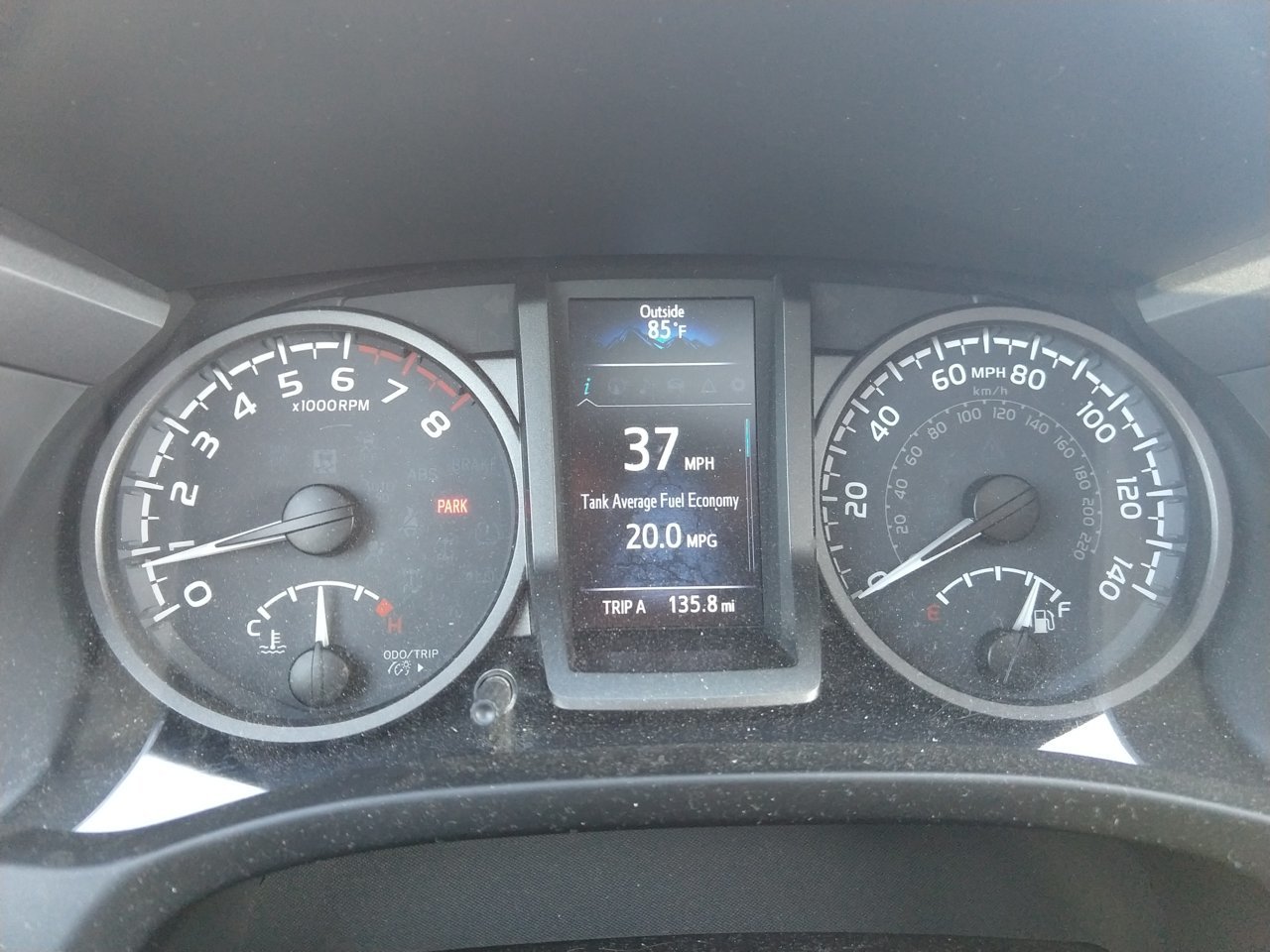

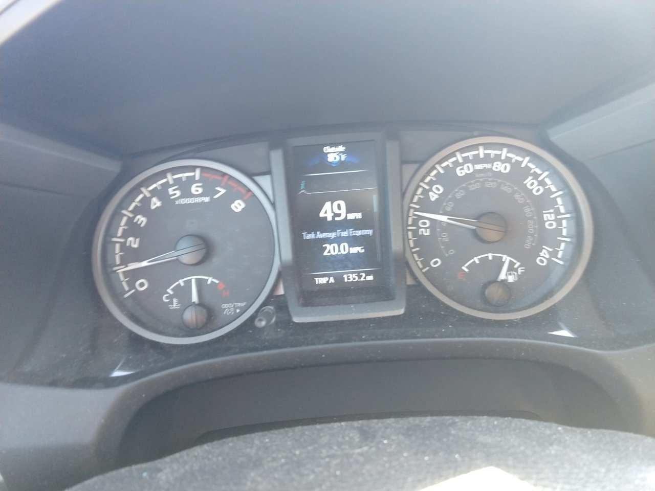

    Noticed my digital speedometer was suddenly way off (see pics). The analog one looks to still be correct. Yes, I will take it to the dealer. Yes, I was very careful taking a photo with nobody else around on a quiet, simple road. It's unnerving to sit stopped in the driveway with the speedo saying 37 MPH. It's a 2017 TRD OR MT.
    Anyone else have this or know why it might happen?

    Try disconnecting both battery terminals. Touch them together for a few seconds while disconnected. Wait a moment or so for a full discharge, and see what happens after you reconnect them.
    This fixed a malfunctioning lift hatch on the wife's Forester where just pulling the negative terminal did not.

    I wonder if that is the average speed? Not the current speed showing on the digital readout.

    Happened to me before in a F350. I did what was mentioned in post #3 and it fixed the problem. Never happened again.

    I assume this maybe would have helped, but the problem didn't come back after simply restarting the truck. Good, but weird.

    This happened in my 17 Tacoma I had before. Its not common but it has been seen on some of the 3rd gens. Someone had their gauge cluster replaced and the issue hadn't returned after that.
    *edit* for me though the analog was sticking and the digital was correct. I'd be doing 45 and the analog needle would have stopped moving in the 20s and would still be showing the speed it froze at.

    Next time it happens, there is an option menu in the entune head unit that’s something like “re-calibrate speed”. Not much into on it, but it may help. It doesn’t do shit for the analog speedo, but may help the digital one (that’s if the digital one is run from the GPS signal).
