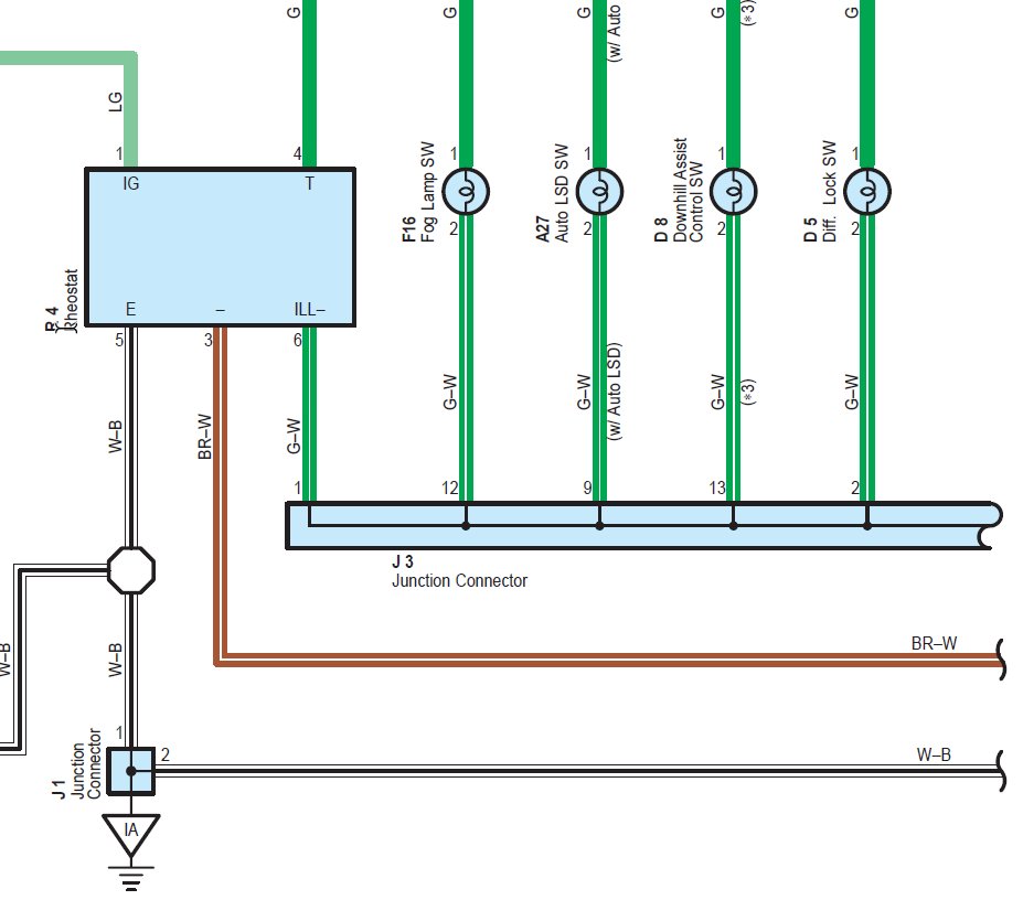

    OP The dimmer works by changing the resistance of the ground leg of the illumination circuit. You could have a defective dimmer or a high resistance connection on the ground side of the circuit.
    Any recent electrical modifications?
    It is definitely not a fuse.

    Try unplugging the dimmer switch. If the dash lights go full bright the issue is with the dimmer switch. If the lights remain dim you have a wiring issue with a high resistance connection.
